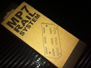

Posted 14 October 2012 - 08:55 AM
http://www.redwolfai...SC_MP7_Rail.htm
hammerson's one ready too
my fma rail system with afg2

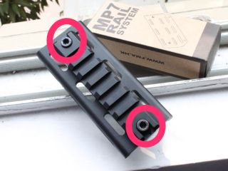

oh, and the screws on the fma rail system sticks out higher than the rail itself, making it impossible to slide the afg into the rail. so i use different screws that came with the moe polymer rail to make it flush with the rail.

And yes the screws on the FMA rail are too tall. I used the screws but took the heads down with a grinder and made them flush with the rail and touched it up with some gun bluePosted Image[IMG]http://img.<br /><br />Also had to modify the afg to slide back far enough to fit<br />Pic in next post<br /><br />( o Y o )<br /><br /><br />
