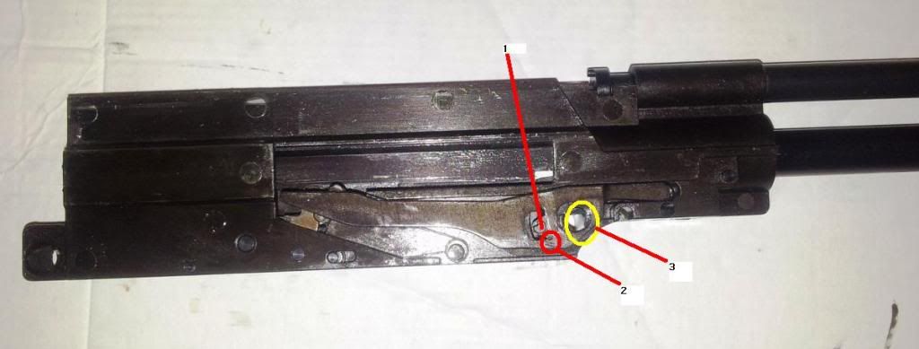

Hi guys,
since yesterday i've really curious problem with the fullautomode of my MP7.
When I shoot semi everything works fine.
But if I switch to fullauto, I can shoot one salve untial I leave the trigger.
It doesn't matter whether the salve in FA was 2..3.. BBs shoot out or an whole magazin, so long I dont leave my finge from the trigger unit.
After that it shoots anymore, feels like the MP7 is not charged (no back pressure of the triggerunit)
But when I put the selectorswitch back to semi and subsequently to fullauto, its possible to shoot out one FA salve again...
Is this problem known by someone ?
greetings

Oh man too bad your a day late in posting because i just finished fixing an MP7 with the same problem you have. There's no easy way to describe it but it is easy to fix. If you can pull out your entire internal mechanism and take a picture of the right side with the barrel pointing away from you i can tell you what to fix.

#7 vovi87
vovi87
  • 10 posts
Posted 08 June 2012 - 10:02 AM
Here the picture from the rightside internalsystem:

No. 3 is your selector switch and no.1 is your selector arm that moves up and down to manipulate the selector lever. With normal wear and tear this will start to loosen and have a play. So when it loosens your no. 1 that moves down to position no. 2 for full auto mode will no longer remain in place due to recoil. It will move up "A LITTLE" disengaging the hammer. So when you move your selector to single and auto again it will push down again and start to function till you release the trigger and it moves up again.
I fixed this by putting very little epoxy between the selector switch (3)  and its Shaft to remove the slack. and a little at the no.2 position.
That's how i fixed the problem with mine.
Make sure that if your going to put anything between the selector switch and it's shaft the selector swwitch must be pointing down to full auto mode.

So I tryed to fix it, but it seems it doesn't work.
