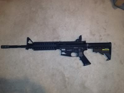

#39 niko_gpsy
niko_gpsy
    What's a Warranty?
  • 6,141 posts
  • Location:Atlanta, GA
Posted 08 June 2012 - 12:54 PM
View PostBoobieM4H, on 07 June 2012 - 05:26 PM, said:
http://www.evike.com...oducts_id=37052
i ordered this today..but i cant find out if it comes with its own barrel nut or if the LM4 barrel nut will fit. if anyone has this on thier aeg or gbbr or knows if it comes with barrel nut let me know please..
I just put a 7" daniel defense on my LM4 and it came with a barrel nut.
Not done yet with my build but heres a bad pic from my phone
#40 devil69
devil69
  • 33 posts
  • Location:Central Illinois
  • Interests:Mainly firearms, firearm replica's, military, law enforcement, PMC/PSC, video games
Posted 08 June 2012 - 01:22 PM
That the stock barrel length? Seems, long....haven't physically held mine yet Sooo sorry if it was a dumb question
