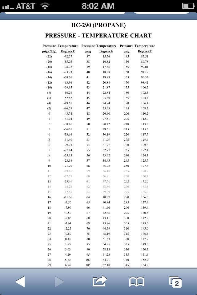

Posted 26 December 2012 - 08:04 AM
You can see at a specific ambient temperature the actual presure of propane. Posted Image
