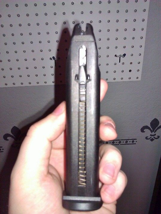

Have you guys seen this happen before?
It happens every now and then, most times when i fire quickly.
The bottom two BB's merge together.
i am using javelin .2g bbs

There is kind of too much glare to see the BBs easily but I'm guessing the spring is just too strong and it is smashing the two BBs at the bottom together. This is just a guess as I am not sure whether or not that is actually possible/strong enough to do that.

It is the mag for sure. I lowered the thing that pushes the bb's up and it moved the bb's a little and they got stuck again.
new bb's .23
the KWA bb's that came in the bag got jammed as well.

The problem is the follower. Do you see how it is rounded and this pushes the bbs apart? If you look in the pic they are no longer double stacked, they are side to side. This means more force is exerted against the walls of the mag and the bbs stop moving. It can especially jam when they get to the part where the mag channel decreases in width.  The solution would be to dremel down one side of the follower so it pushes the bottom two bbs in a stacked fashion.
I give credit to Maekii at ASM for this trick. It made a world of difference with my midcaps. This metal follower will be more difficult but the principle is the same. search "folloer mod" at asm and you will find the thread. Here are two pics from that thread of Maekii's
