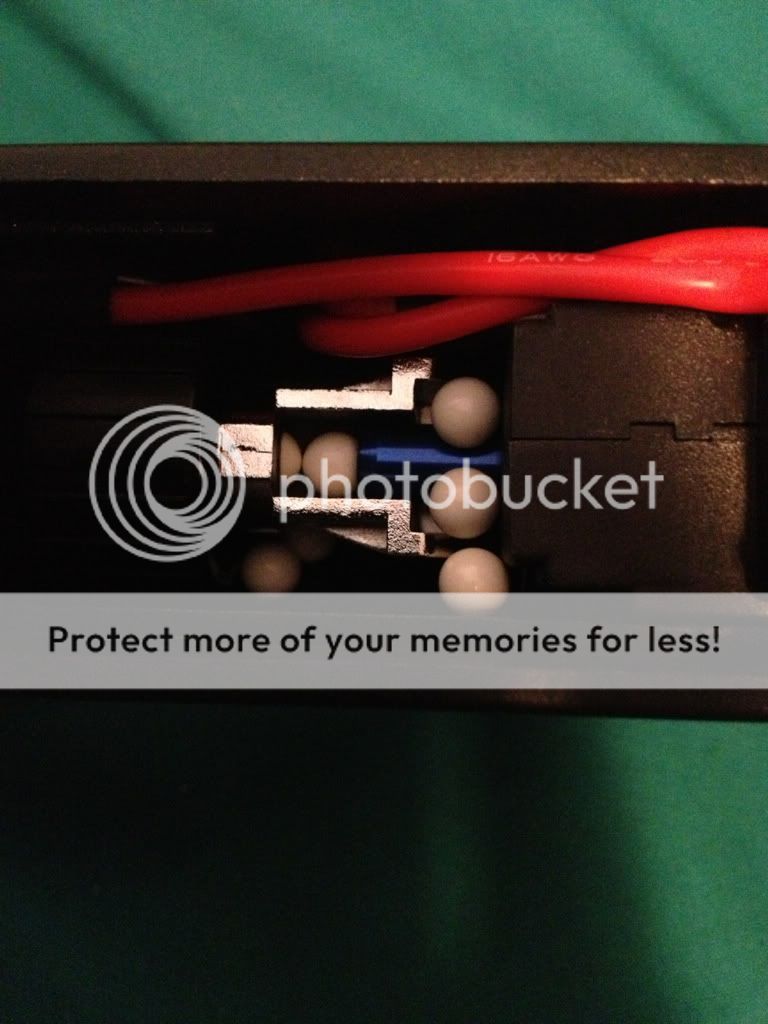

Alright, so this is getting more confusing by the day.

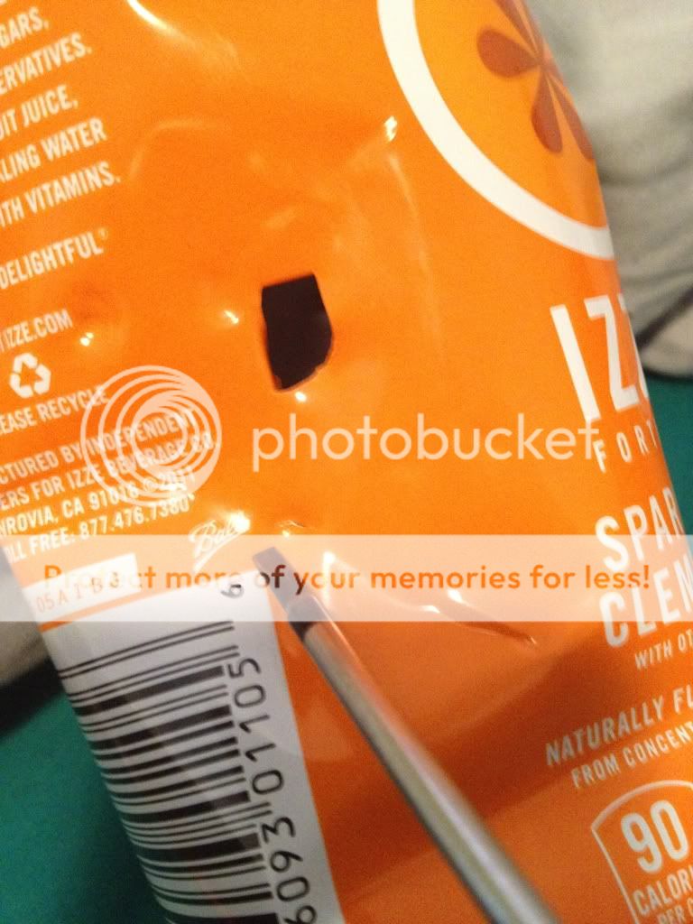

The new SHS nozzle seals perfectly with the hopup, chamber it fixed a minor airleak in the cylinder/nozzle setup, BUT DEAR GOLLY IT WONT PASS 250FPS!
I tried the poor mans chrono, and it wont even pierce the side of a can (Must be below 280ish)
I tried loading a mag in the gun, removing the mag and then taking off the mag well and i found this:
After removing the extra bbs:
It seems that the reason its double feeding is because the nozzle goes too far back.
Should i replace the cylinder head with a longer G36 one?
Should i replace the nozzle with a different one?
Edited by colonel249, 24 October 2012 - 05:56 PM.
#33 colonel249
colonel249
  • 12 posts
  • Location:Kapolei HI
  • Interests:Airsoft, Airsoft, Airsoft, Piano, Music, Tacitcalness and Chairsofting on forums like a boss.
Posted 24 October 2012 - 06:01 PM
(The hole in the orange can is from my Marui AUG. The smaller dents around the can are from my g36.)

#35 gcw360
  • 11,933 posts
Posted 25 October 2012 - 04:16 PM
In all honesty, I would go back to the OEM hop-up, bucking, nub, and nozzle. I don't remember you changing the cylinder head.  I'm guessing here but it seems like you may have a mixed compatibility issue...meaning the the parts you have mixed are not compatible.
While you are at it I would try a stock piston and piston head.  This is simply to get you back to square one and then, from there, you can determine logically what is causing the issue.
#36 niko_gpsy
niko_gpsy
    What's a Warranty?
  • 6,107 posts
  • Location:Atlanta, GA
Posted 31 October 2012 - 01:25 PM
You may have perfect compression internally all the way to the air nozzle but it seems that the new air nozzle is not mating very well with the bucking meaning that it's either a little too short or the tip is too wide.  I have seen from personal experience that you can lose 100 or more FPS between the air nozzle and the bucking when not properly mated.  Take gcw's advice and go back to the stock form but use a new KWA air nozzle.  Your current one could be worn out or damaged.
