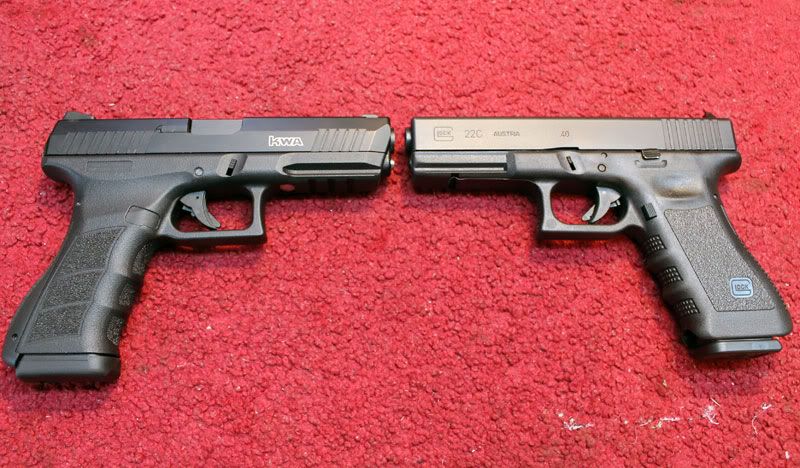

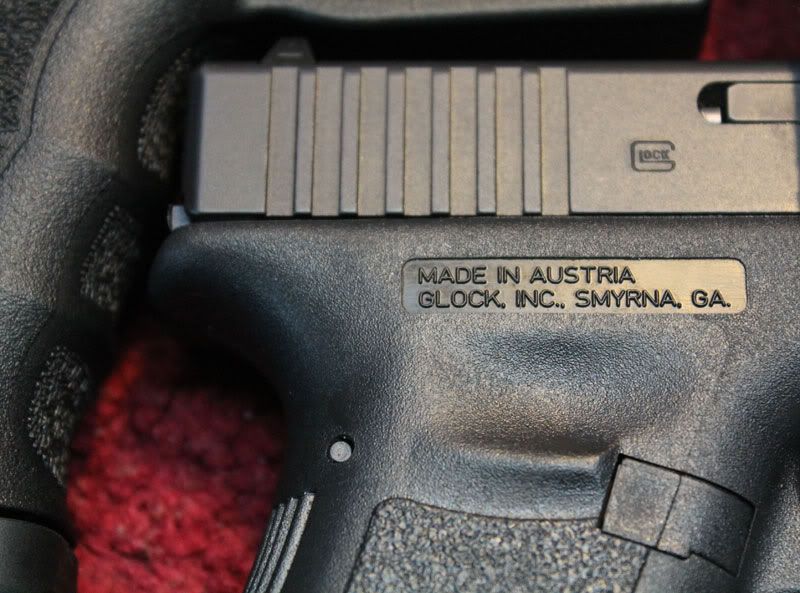

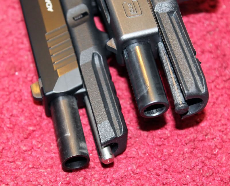

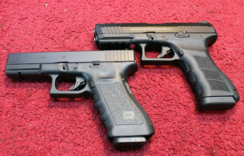

Lets see how this stacks up to the real thing, here are some side by sides with a 22C .40:
The ports in the 22C, I like these and may do something similar:
I didnt notice the Glock was so dirty or I would have cleaned it before the shoot, but the KWA is pretty darn close:
