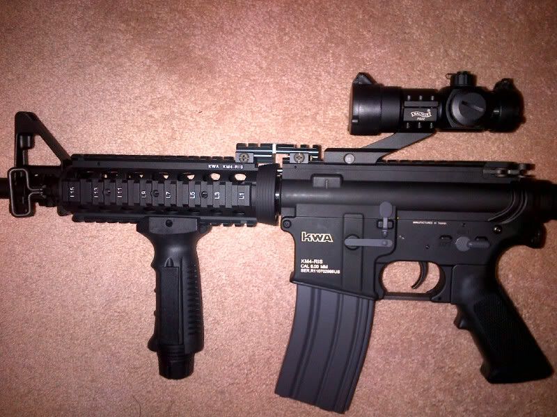

I just want to thank you all aging for your assistance with this. I purchased the bridge part that JROC311 suggested. Awesome suggestions by the way. Here is a pic of it installed just in front of my red dot sight. The fore grip and RIS are now SOLID AS A ROCK!!!!! This made a world of difference for me. Everything on this gun is so solid and this little wobble really bothered me. Now it is PERFECT!! Thanks again guys :-)

Glad it worked for you! Looks good, and still lots of mounting options for a buis if you ever wanted to use one also. And thanks for posting a pic!

Hey, I know this post is old but I found a way to stop all the wobble.. Use an accessory that is long enough to connect the upper receiver rail and the top rail of the ris, for example I used a little scope riser mount, this eliminates the top part of the ris wobble, for the bottom half of the ris, I put a thick rubber band around just the bottom piece right behind the rail and put it back on, feels so much better now, and the riser mount adds a neat look
