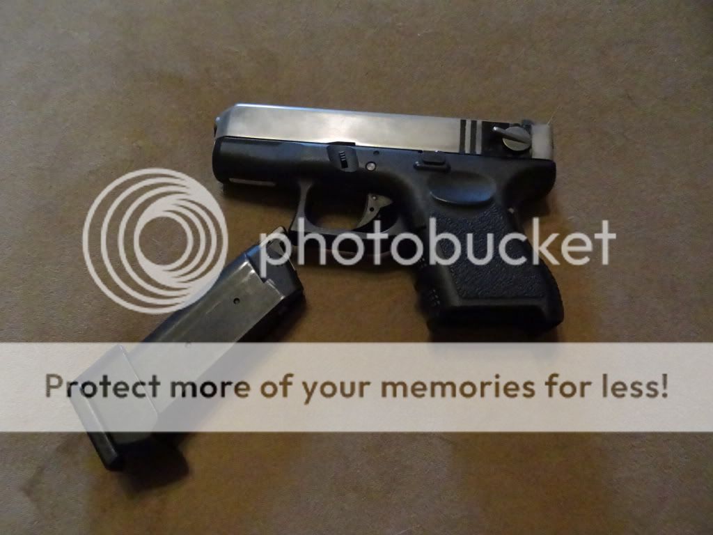

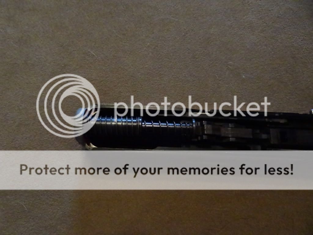

I recently acquired an M26c in a trade with two mags. When I did the trade, I knew of the problems it had (Full Auto no matter what mode) but when I got it, it had far more problems than I was told.
Oh well...
Onto the gun:
-Everything is stock except for the recoil spring (Was told it was a Real Steel Recoil Spring and had only been shot with one mag to make sure it worked fine in the gun).
-Full Auto Assembly was replaced recently with a KWA Full Auto Assembly.
^These are the things I was told (and from looking at the gun, I can confirm).

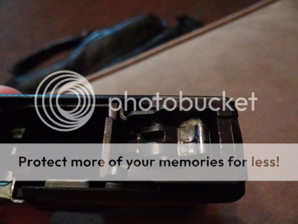

My first problem is that Full Auto doesn't actually work well at all. It locks up after almost every shot (Same problem in Semi too). I have to rack the slide after every shot to get it to work.
I noticed when I fire the gun it shooting 1 1/2 times per trigger pull. It will fire one BB but won't fully cycle for me to be able to fire the next shot (Almost like something isn't strong enough to pull the slide back after each shot).

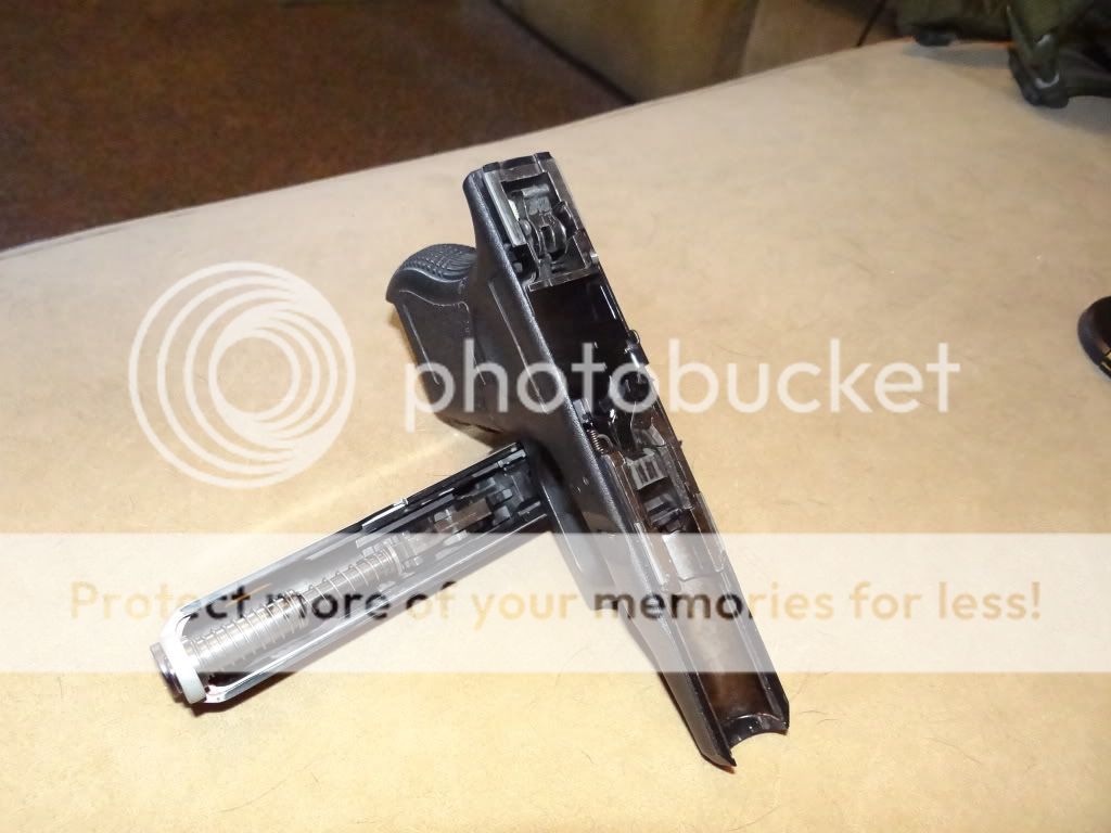

When I go disassemble the gun, I pull the two tabs and the slide should go forward right? Wrong!
I have to take a tiny screwdriver, stick it through the back plate (after I have pulled the tabs and made the slide go forward a little) and slightly push down the hammer to allow the slide to come off.
Picture(s):

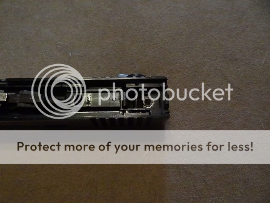

The other thing (More of a worry than a problem) is that the trigger mechanism that is attached to the hammer is Gorilla Glued on (As if they couldn't get the piece to fit right or something...). Not sure if this could be why the hammer won't go back all the way when trying to be disassembled or not.
Picture(s):
Extra Pictures:
Thanks in advance for any help!
Also, If you could give me a close estimate as to what this will set me back/what parts will need to be replaced, that would be much appreciated (So I can know if I will need to put more money aside for this)!

First you should try oiling the hammer/firing assembly.  It looks dry from the picture. You just add a few drops of silicone oil in there and it may solve your woes.
The other thing is try to clean the slide rails with some q-tips and re-oil lightly with silicone oil.
Finally, why are you using a "real Steel" recoil spring in an airsoft gun?  That spring is too stiff for your gun to cycle properly.  Try a lighter spring.

The stock "real steel" recoil spring for a Glock 26 is 16 lbs.  There is NO WAY that an airsoft pistol could cycle that spring.  Get the right spring and it just might fix your problem.  This could easily be the problem with dis-assembly as well. Call KWA customer service, they still have some parts for the "M" series but they don't list them on the website.

That may be the problem with the disassembly but I highly doubt it because it's more of a hammer problem than anything.
I'll have some time tomorrow to lube everything up and I'll see if that'll get it. If not, I'll contact customer service and see if I can get one.

Being as curious as I am. I got the slide off and before I could get my silicone oil out to lube the gun, I had done something else to cause yet another problem...
Here's a video to better show the (new) problem:
You can cut the video off after 4:45 (I start to give an update about new content coming soon for my channel)
I'm probably gonna end up sending it in once I have enough money to cover parts and labor...
