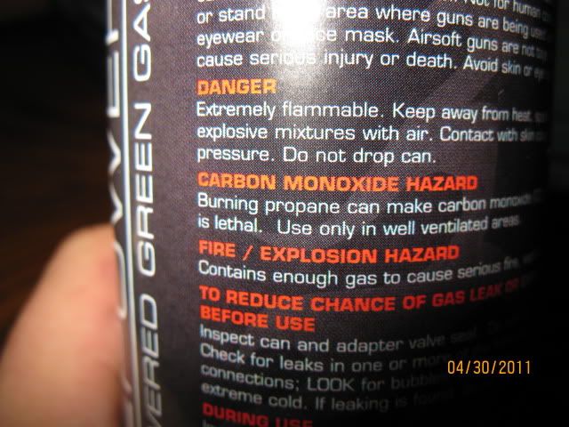

#9 SR5Jonathan
SR5Jonathan
  • 258 posts
Posted 30 April 2011 - 09:03 AM
View PostAge_N_Treachery, on 20 April 2011 - 04:22 AM, said:
On a side note: everything I have ever read from reputable sources has stated that green gas and propane are NOT the same thing. GG is actually a variant of freon.
Not true, I just picked up a bottle of GG for my USP coming next week and all it took was reading the bottle to see what it is:
So the point that Propane "gums up" guns is moot, as GG is propane.
Edited by SR5Jonathan, 30 April 2011 - 09:10 AM.

#15 SR5Jonathan
SR5Jonathan
  • 258 posts
Posted 30 April 2011 - 04:48 PM
View PostWhiteWhale, on 30 April 2011 - 03:16 PM, said:
So, it lists all of the components in the can like a wrapper of ingredients?
Wonder how many calories it has per fill...
What?
GG=propane+silicone.  Period.  So if GG IS propane, than the contents of propane (as it pertains to harm to the gun) is a moot point, because its in GG.
If anything, how do you know what is added to GG?  The contents of propane are more well known than the contents/additives of GG.
Edited by SR5Jonathan, 30 April 2011 - 04:52 PM.

View PostSR5Jonathan, on 30 April 2011 - 04:48 PM, said:
What?
You can't say it's a moot point when I've seen the gumming up that it does on SEVERAL guns that come in for repair.
You don't know the quality, consistency or mixture in the can. Again, nothing has been proven about the COMPLETE contents in green gas, so you can't just say the issue is finalized because a can has it listed as ONE OF THE CONTENTS. It's FACT that certain propane does gum up the internals and I've never seen it with green gas usage. So it could be the quality of propane in the mix that allows it to not have this issue, or something else. We aren't saying that there isn't propane in green gas, we are just saying that it's not as simple as just propane and silicone oil.
You haven't really proven anything with that picture of the can, but I understand where you're coming from.
