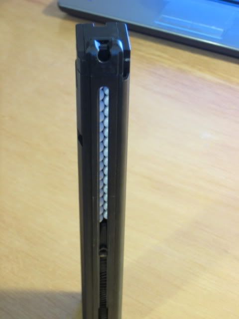

Loving my new KMP9, but I am having some magazine troubles. I have tried both types of BBs that I have with me, being Bioshot .20 and .25 grams. Using both, the magazine follower doesn't seem to be able to push the doublestacked BBs reliably to the feed lips of the magazine. Every third or so shot fires a blank and I need to take the mag out and reset the follower to get the next BB to the feed lips.
Has anyone else had problems with different brands of BBs? I am assuming that the problems stem entirely from BB choice, but in my experience, Bioshot BBs are extremely high quality and I am surprised to have problems with them.

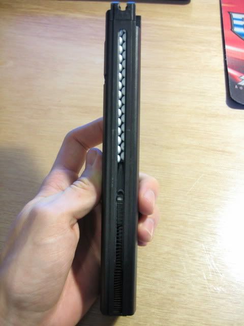

That's not it. They seem to doublestack well enough, but the follower can't push them up to the feed lip. It seems like there is some ledge or seam right below the feed lips that the BBs don't like going past. Additionally, when I pull the follower down and release it, it is VERY slow in pushing the BBs upwards even before it hits the point where it stops. It feels like a strong enough spring, but...
Pics:

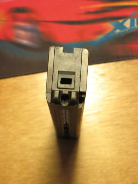

I have the same problem, but only on 2 of my mags. After taking the mags apart i found the problem. If you take the head of the top of the mag, you can see that the hole the BB's come out of the clip has 3 round corners and 1 square one. The BB's always get stuck on the side with the 2 round corners. I sanded the corner opposite of the square one and now all my mags work flawlessly. It sames the side with the 2 round corners was just to tight for the BB's to flow though.
EDIT: added pic
