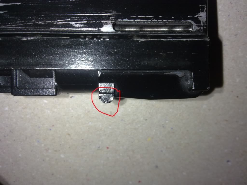

the magazine is ok I have two extra magazines, from my old KWA mp7. Tiger help me out already with this. The striker tip of the bolt carrier is too short (not molded right). I ordered a stock bolt carrier from KSC anyways, I contacted KWA but they're out of stock. Thanks for the help anyways

mine was because of this image below, the striker tip was not hitting the lever well enough to set it off.
this is the one that tiger was telling me, I have extra mags and i actually have to cock it twice to all the mags. Plus I wouldn't doubt it if my bolt was kind of deformed or molded wrong because its an aluminum bolt. Not a strong type of metal and lever that hits the striker tip is made of steel. Plus mine is made in Taiwan (KSC mp7 Taiwan version, alot of Taiwanese guns have cosmetic defects due to poor quality control. KWA has better quality guns than KSC IMO.

I just finished doing what you just said, I scraped some material off and now easier to put BB's in my mag. But its too bad it didn't fix my problem, tiger was right about the striker tip. Plus the BB's feeds in well in the barrel, I can see it from the inside when I cock the gun on my first try. Although, I noticed that the shape of my striker tip is not as round as my old KWA bolt carrier, its a bit scrapped off dunno how it happened. Thanks for the advice anyways, now I can easily put the BB's in the mag.  :thumbsup:
