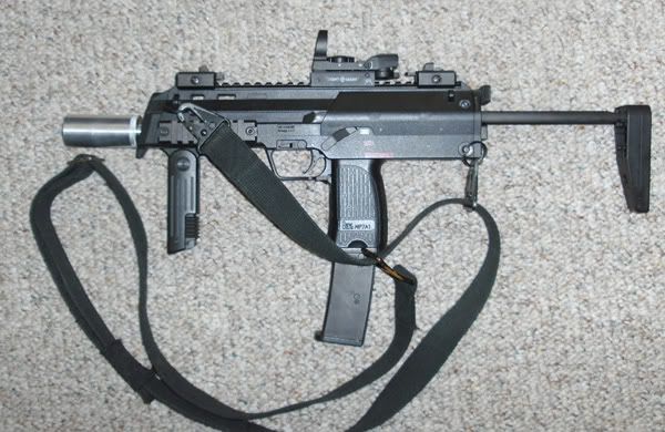

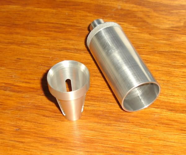

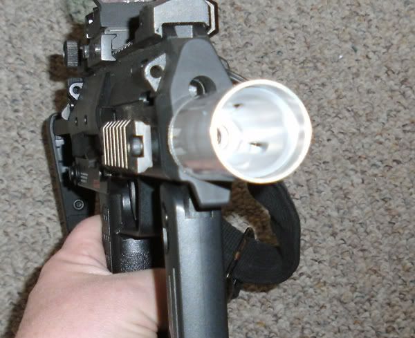

Some detailed pics of my amplifier:
Nothing very original I will admit, but it works great, and is threaded for 12mm so I don't have an adapter on the gun:
Picture of the cone before I pressed it in:
I tried doing a sound test video but the camera auto adjusts the sound, making them both sound similar, you can see that they are not by watching the decibel meter, but the video does not do the MP7 justice:
#23 Spiggy
Spiggy
    Member
  • 2,136 posts
  • Location:City of Industry
Posted 30 April 2010 - 08:08 AM
You'll need a longer inner barrel, the muzzle needs to seat around the base of the amplifier's cone.  Works better if you get a tapered endmill and run it into the muzzle for a deep crown.

#25 dobey
dobey
  • 234 posts
  • Location:NY
Posted 30 April 2010 - 10:25 AM
My cone is pressed in, I just copied the design from a popular brand I saw on the internet.  I left about 1/2 inch from the end of the inner barrel to the beginning of the cone but if it will work better touching I just need to press it in further, I will give it a try.

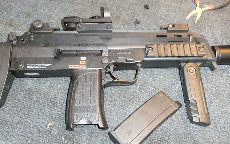

I finally took my MP7 apart completely today to clean it out after a particularly dusty game.  As a machinist I am particularly interested in the details that most users never look at or notice, and I have to say I am impressed.  This thing is put together better than any airsoft gun I have worked on before.
The pins have the proper fit, the castings are superb, details like the blind holes for the set screws to seat in are amazing to find on a piece that costs so little.  I have no idea how you guys are making money with this thing but it is a piece of art.
I need a picture still but while I had it apart I cut the ejection port side selector lever off and put the nub in the lathe to turn round.  I am right handed, will never sell my gun, and was tired of the thing poking me in the hand on full auto. I will get a pic up soon.

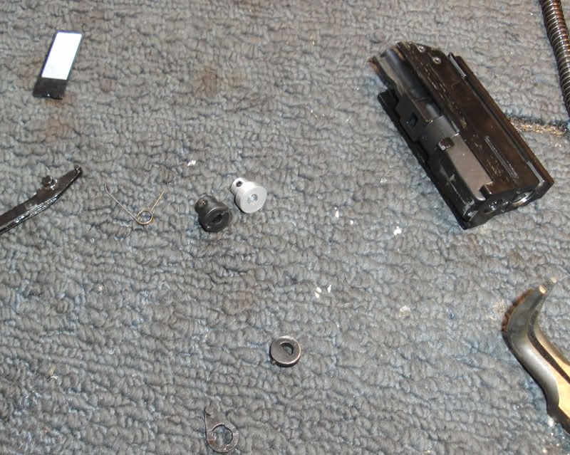

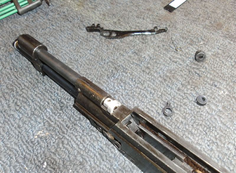

Well I managed to break the plastic cam that adjusts the hop up (part 14) by over tightening the set screw that holds it onto it's shaft.  Completely my fault but wanted to let people know so they don't suffer the same fate.
I will be machining a new one today from aluminum and I think I just might play around with the cams offset and shape to modify its adjustment profile.  I use 0.28 bb's and one click is just a bit under hopped and the next click was just a tad over hopped so I will make a flatter profile on the cam and see what happens.  I read a very cool old-school (circa 1940's so the term is not being misused) article on cutting cam lobes on the mill with the rotary table and have been looking for an excuse to try it out, maybe I overtightened that screw subconsciously.  :innocent:

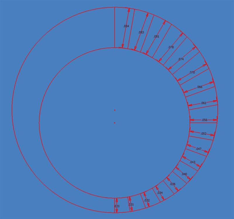

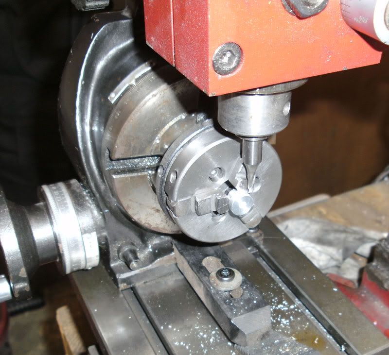

I made the new cam, here is the profile I decided on.  It is only slightly different than the stock one, and was cut every 10 degrees on the mill.
This is the little guy after the lathe work was done, I would make a cut, rotate it 10 degrees, set the depth and make another cut, until I was all the way around.
All finished and next to its broken counterpart:
Fits like a glove and works fine!
And a pic of the chopped up ejection side selector switch I promised a few posts up:
Now I need to break something else so I don't get bored.

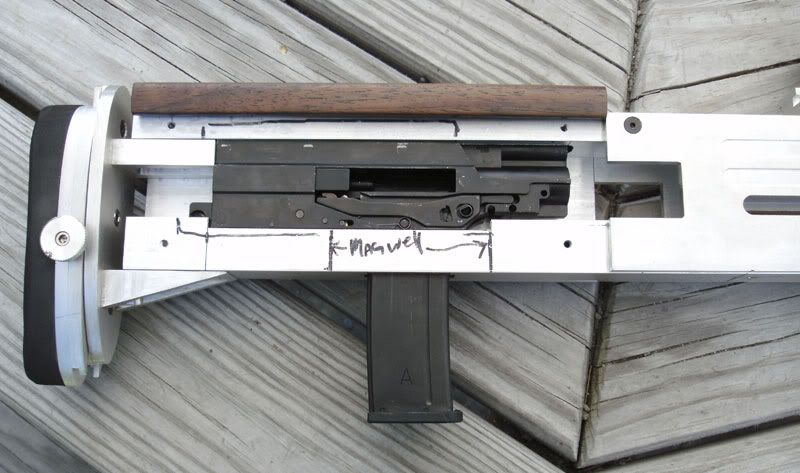

Posted 27 May 2010 - 11:47 AM

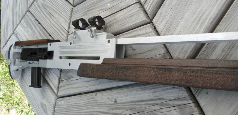

I think this still counts as a modification to my MP7 :P
It just happens to fit so perfectly into my WA2000 build that it is going into it permanently.  Of course it will be set to semi auto only, and I will be shopping for a new MP7 for my own use again, but check out the beginning stages of my GBBR WA2000 'powered by KWA' (any objections to me engraving that on the gun?):
Still lots to do like a fake WA2000 magazine that will function as the mag well for the shorty mags and trigger linkage etc, hope to have it shooting in a few days.

#40 jotohomomoto
jotohomomoto
  • 120 posts
Posted 31 May 2010 - 05:41 AM
@dobey
OMG!!! what is that gun going to be?
Also, what does that "cone" thing do? The cone makes the gun sound louder/meaner? :shocked: Whenever I'm in an engagement during a game, everyone knows who is firing at them: "...the guy with that GAS mp7!!!"  :thumbsup:
