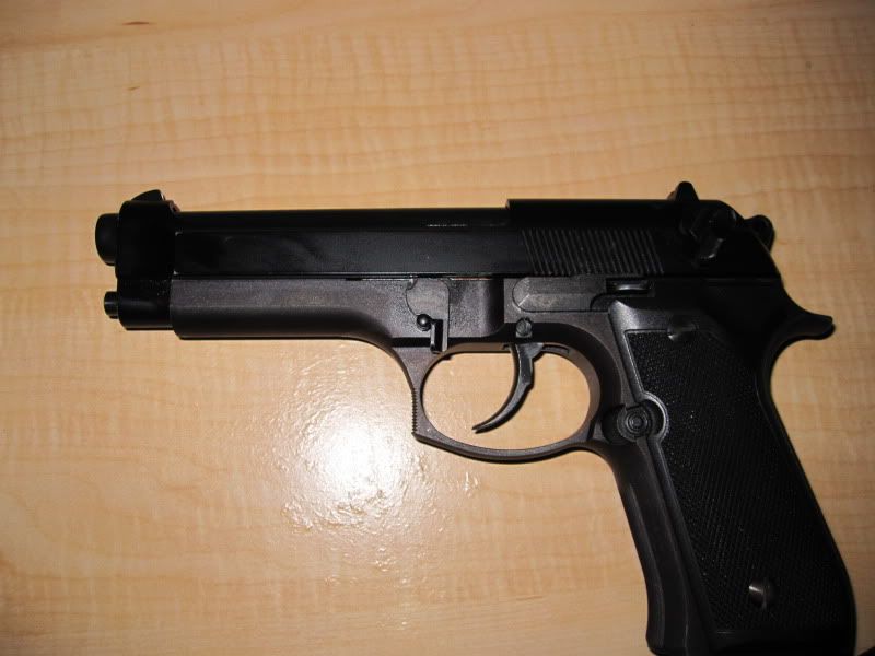

I have a kwa ptp m9. After disassembled it and lubed it today, I put everything back together. and boomed, the gun can't cock back any more. I try to take the slide out but it won't slide out. It seems like something is blocking it from the inside. I have no clue how to fix this. And I have taken the mag out but the slide still won't come out.

can we get some pictures please

O yea, definitely jammed, happened to my M226 as well; you really will need to literally jam this thing off. Also try undoing the safety lever as well

put gun to fire mode and then try the trigger hold and see if it goes on if not try to take it off holding the trigger. If it doesnt come off easy than that is to be expected just spray some lube on the rails and move it back and forth until it comes off.
Once off.
1. Make sure everything is in place and the spring guide is straight
2. Dont turn the top receiver over leave the internals facing you. and take the pistol grip and make sure grip is facing you and then align it on
3. Safety off and field strip make sure its still down and hold trigger
4. Pull back quickly and hold back
5. push the field strip level back up
6. let go

also another thing u could try doing is get some needle nose pliers and take the spring guide thats sticking out by the muzzle and pull forward and this might help unjam it

Nvm, I found the diagram. The locking block is broken, I will order one of those. Thanks everyone

gently tug the spring guide with a pair of pliers, pop the barrel with the soft palm of your hand gently and it should budge
