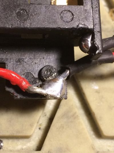

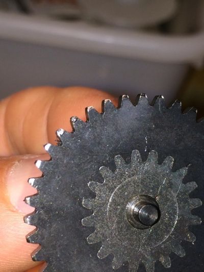

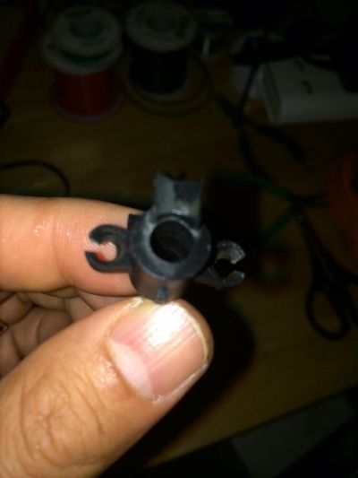

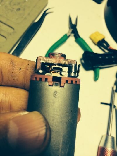

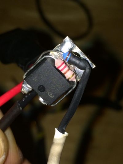

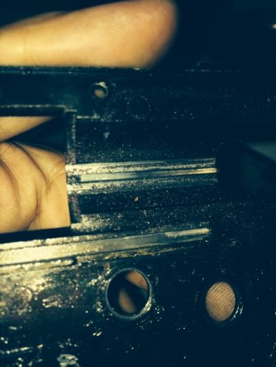

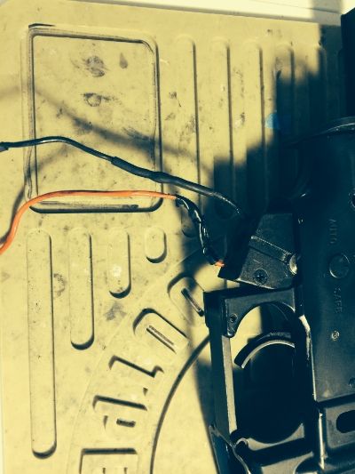

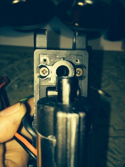

Fellow airsofters, I appreciate everyone's opinion on this matter. First and foremost there was no contract signed or otherwise, nor did I agree to any terms or conditions. I also have no intention of using any legal system regarding this. In my post I was trying to not bore you with more detail than was needed and just talk specifically about the quality of work I received from Vanevery. Vanevery wants to talk about what he said or I said which has absolutely nothing to do with the quality of work, the bottom line is every single time I got a gun back from him it failed the first time I used it in a OP, not the second time, or the third time or the forth time, but the first time. In the four years prior working with another tech who upgraded my guns, I never had this problem. A big part of why I stopped using Vanevery was because of his continued written insults which he still continues to do. When my sr10 and my Mod1 went down at the OP on Saturday when I had just picked them up from him on the Thursday before I wrote him saying enough is enough and I may want some money back. Saying I am trying to shake him down is ludicrous, I was and still am a unhappy customer. He wrote me one of his war in peace emails telling me the first three times he repaired my sr12 it was "user error" and I am a customer who "doesn't listen", and of course no refund partial or otherwise. He accuses me of being aggressive with the wiring and the battery and being the most aggressive he has ever seen. This is a outright lie! I never had any problems with my batteries or connections the four years prior and I have always used XT60! As far as his time on the road, he drove to Greensboro once, I drove and met him half way three times, and drove to his place of business at least three times which is a two hour drive for me. I guess its easy for him to save face and blame it on the customer. He mentions all the ancillary items he gave me and places a value on them as if it had anything to do with the quality of his work. I did not ask for batteries, I did not ask bbs, I did not ask for a sh*t a** lipo bag, all I wanted was a gun that worked. Speaking of batteries I gave him one of my 50$ Bol 11.1 lipo batteries so he could test etc the guns. He admittedly Fried it and did not offer to replace it. One very important thing that he conveniently left out is that when I got my sr12 back the final time it has a really bad power burst in the semi mode which is the only mode it has. So bad in fact that when I used it in a Op two weeks ago it went from a power burst to now just shooting full auto and misfiring, I guess that's end user error as well.
My primary m4a1 was the next he so called upgraded, I explained the before and after performance in my post above. When I got it back the last time it sounded so bad I sent it to a reputable tech. What he found was the sponge Vanevery put in the spring degraded and totally trashed the gear box. There so many other problems with that gun including the wiring, soldering etc and what vanevery did to it that I will be spending at least 300$ to correct his work. As far as the "new motor" he claims he put in, the tech that looked at it said he has seen motors that have shot 100,000 rounds though it that didn't look that bad. I don't know what this means but over half of the motor brushes were worn down. Guys, let me ask you, warranty or not, would you keep going through this. I have sold surgical devices for over 20 years, how many times would a surgeon buy my device if he had to keep sending it back for a problem? He doesn't give a sh*t about a warranty he just wants what he purchased to work, period. In fact, he would ask for his money back. And I certainly would not fall back on some fictitious contract he never signed or looked at and try to posture him with bs legal speak like "breach" etc. Most legit businesses do not require money up front to operate because they completely want to make sure the customer got what he paid for.
I picked my sr10 up on a Thursday before my Op on Saturday. In the Op the gun went down as I should have guessed. When it was reviewed by another tech he told me the zci motor went bad. A new zci motor going bad on the first Op with less than 1000 rounds shot with it! He also confirmed this was not a new motor, it was greatly used, scratched and had marker markings on it. Sure, he dry fired it in the parking lot, big deal. Admittedly he said he did not field test the gun. That's for sure, because with my hop up all the way off the bbs were rising so bad you couldn't hit anything. Oh, that's right, I don't know how to use a hop up! what kind of bs was that. When the tech first opened the gear box he asked me " did Vanevery mean to leave all the screws out of the top rail to the gear box", I looked at it said I didn't know. I asked Vanevery this and he denied it. I told him the name of the shop and tech and he could him he didn't believe me. I guess that's end user error or abuse as well.
My other two guns also have issues, I just haven't had time to break into them yet.
In closing on this, as you all have opinions, these are mine and my experience. Everything I have said is a fact and I can back it up. I am focused on the quality of work so maybe others may not have to go through this, he can talk about us shaking hands, or what I said, or whatever, that's not the issue. Also, I am not looking for any of you to pick a side, I could care less.

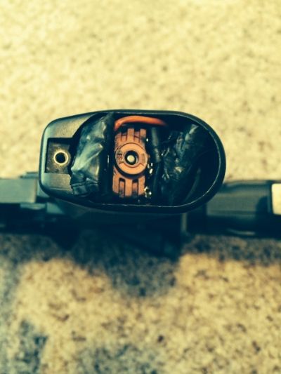

MOTOR: The first thing I noticed when I opened the base plate of the pistol grip.
I don't know what is going on here.  There were electrical tape rolled up to push the motor into to grip. This should have not been done since it can hinder motor height adjustment and free movement.  If the motor was out of spec and was not a good fit the customer should have been notified with alternatives.

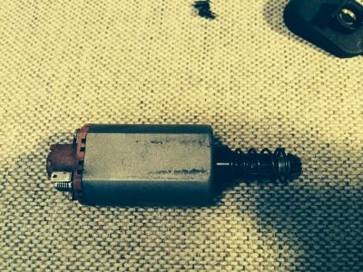

The actual motor.  I have read vanevery's report and also his earlier response posts that this was a brand new "ZCI High speed motor."  I have found that the brushes were worn down by more than half and it looked to be in a bad shape.  Can't say if this is a QC issue since this was supposedly brand new but one thing to note is that this high speed motor was used in this build to pull a Madbull M/SP140 which is more like a standard M150 spring.  Most if not all high speed motors are rated to effectively pull M120 and "maybe M130" spring at most.  I think this motor was a very poor choice for this setup with such a heavy spring.  The excessive load on this motor (beyond what it was capable of) is probably the reason the burshes were destroyed and the motor now probably damaged.  This gun was shooting at around 16bps (11.1V 2200mah lipo)  at 380fps with 0.20g bb's when I tested before disassembly.  The trigger response was very slow even with a "mosfet" and an XT60 connector.  It sounded very scratchy as if the motor height was not set correctly and I couldn't adjust it to sound smooth.  This is probably from the tape in the grip and a bad shimming on the bevel gear.
Posted ImagePosted Image
WIRING: I read a report sent to drudog about new wiring that was installed on this M4A1 and I found heat shrink and electrical tape around the wires that go in the pistol grip for the motor. The entire length of the wiring should have been replaced since the tape and electrical tape can make the wiring too thick in the pistol grip for proper motor alignment and height.  Not to mention the electrical tape can come off exposing the strip in the wiring that it was covering and short out the electrical. The wiring was not replaced as the report indicated.
The new soldering on the trigger switch assembly.  I think there was too much solder used.  The excess solder could make contact with the gearbox shell and cause a short.
The wiring leading to the mosfet and battery look ok but I would have used a smaller gauge (22AWG) wiring for the fet signal wire.  It would have set nicer inside the gearbox that is already very limited in space.  There was a lot of heat shrink around the bullet connectors and coupled with a thicker signal wire had some trouble pulling it out of upper receiver opening for disassembly.
MOSFET: This was a simple enough fet for trigger contact protection.  One thing I noticed was the the negative wire was SOLDERED to the fet heat sink fin which is a NO NO.  Just the process of doing so can short out a fet and lead to a short.  When building fets you want to use as least heat as possible (around 25W setting) and very short times when the soldering iron makes contact with the fet.  Excessive heat can kill it.  It's always advised when going this route to simply use small screw and nut to secure to the sink fin. Also a little heat shrink around the resistors couldn't hurt either.
Once the upper receiver was removed I noticed this on the bb feed ramp.  The side tabs that secure it was snapped open and it should have been replaced or at least let the customer know if there was not enough time to do so.  I found the screws to have been extremely over tightened and had trouble getting them out.

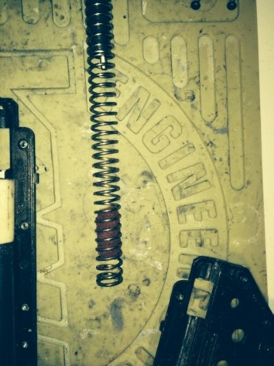

SPRING:
The spring is a Madbull M/SP140 (gold in color). Nothing to report here other than that there was a sponge inserted into the spring. I can only speculate that it was placed there to dampen the heavy spring sound when it's decompressed.  Wasn't a good idea however since this sponge broke down and left a very heavy film of sponge fragments mixed in with gear grease all over the inside of the gearbox.  It could hinder performance and lead to catastrophic failure.

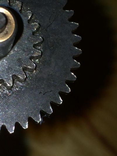

SHIMMING/GEARS:   I found visible damage to the teeth of the spur gear.  Only the top side of the teeth edges were warped and damaged which indicates that the bevel gear was shimmed too high and/or spurs gear was shimmed too low.  Maybe both judging by the damage on the bottom side of the spur gear and the gouges on the gearbox shell. When building a setup that runs such a heavy spring in full auto shimming (which I never would recommend) has to be perfect or things like this happens.

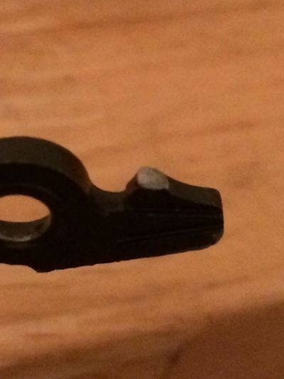

CUTOFF LEVER:  This lever was very worn.  Could be normal wear and tear but it could have also been an overall setup.  I replaced the cutoff in this gun about 6 months ago and the old one didn't look this worn. I read the report by vanevery that stated that this gun shoots in full auto bursts when in semi because of the "excessive heat created by the motor"  or maybe even user error. But judging by the wear on this cutoff, this is the culprit and not the heat or the user.

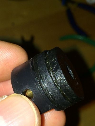

CYLINDER HEAD:  Performed a standard compression test on the aftermarket type-0 cylinder and the modified KWA cylinder head.  A type of gasket maker compound was used around the cylinder head for better compression when inserted into the cylinder.  The compression test results were poor and found air leaks around the cylinder head.  The cylinder head was removed and found that the compound around the cylinder head had hardened and some fused with this cylinder head.  The surface of the cylinder head is no longer smooth and it will never yield good compression in my opinion.

Finally the gearbox shell was radiused, although I feel unnecessary, done well. Sorry no pics. :)

Motor:
The motor in the Picture Taken by Niko is a ZCI Neo Magnet High Torque with an SHS Pinion Gear that I installed. NOT a ZCI High Speed Motor, which has a different color Can completely.
This ZCI HT Motor has more than enough TPA and Magnetic Strength to pull that spring, and with ease. It can pull any spring!
Funny thing is, that specific motor pictured by Niko is the motor Dru himself purchased and then subsequently destroyed his stock KWA piston with. I did not purchase that specific motor pictured, Dru did.

- The Spring that I installed is a MadBull m130 Linear Spring.
A MadBull m140 Spring is an Irregular Pitch, Non-linear Spring.
That is a noticeable difference visually that makes each respective spring identifiable, as well as a difference in color coating.
It would be impossible to not get right in identifying these two springs.
Mosfet:
THAT IS NOT THE MOSFET I INSTALLED!
I installed a Zardichar Micro Mosfet.
The one pictured is a completely different brand and type.
Wiring:
- There were no soldering connections nor electrical tape on the motor wires done by me.
That is not my work!
- No electrical work regarding soldering on a Switch Assembly that I have ever done has EVER looked like that.
Shimming:
- The shimming on that gun I worked on was done using a Bevel/Pinion Gear Method.
I spent hours shimming all of Drus guns.
- Shimming KWA gears can be challenging enough.
Double that challenge when shimming them with 5KU 9mm Bushings.
Quadruple that challenge when shimming multi-generational KWA gears.
- Niko mixed and matched Gen1, Gen2, and 3gx Gears in several of Dru's Guns.
This matters because the Bevel Gear Shafts have different specs for each generation as well as other Spec changes regarding the Sector and Spur Gears. This makes shimming multi-generational KWA gear-sets together very challenging.
- The sound of the gun was butter smooth when it left my hands.
What the other techs have done to this gun since it left my hands is on them, and has absolutely nothing to do with me.
