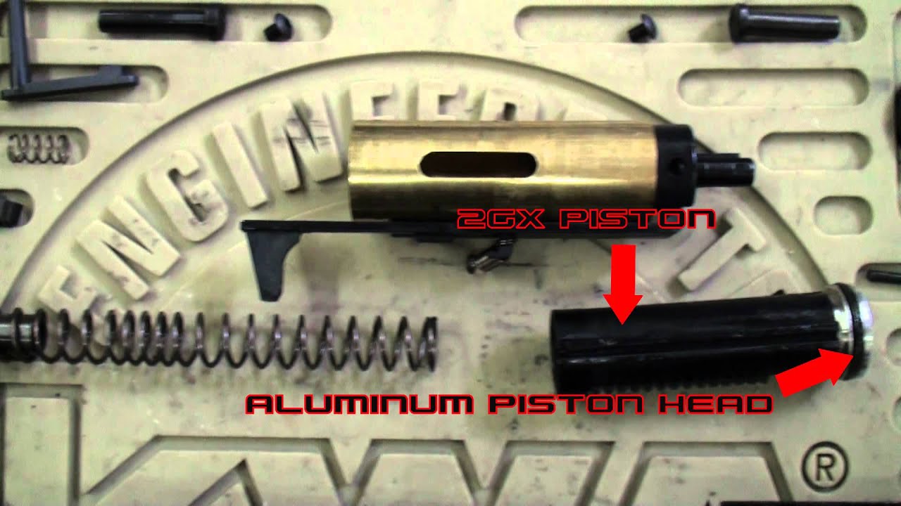

 choochoo, on 17 June 2014 - 08:28 AM, said:
Both the same gearbox, the MOD1 has a longer inner barrel and outer barrel.  That's where the differences end.  Even though the inner barrel length of the CQR MOD1 is approx 400mm vs. the MOD2 at 287mm, they both use the same ported cylinder.
So, there's less air volume pushing the bb.  hence the lower fps for both the MOD1 and MOD2.  But, then there are some variances.  I've had a MOD1 that shot approx 310fps with 0.20gm bbs and right now I have a MOD2 that shoots 320fps with 0.25gm  bbs, which is like approx 345fps with 0.20gm bbs.  This may be due to a new gun and new spring.  But, I think the cylinder is undervolumed for the MOD1 inner barrel.  I personally would go for the MOD2, since it's more compact, which is good for CQB and has no negative effects for the field.
The cylinder shown in the picture is the older CQR MODs 1&2.  In this case the gun has an m120 spring.  The latest MOD series has a type one cylinder and an m100 spring.  The FPS is more stable with this cylinder/spring combination.

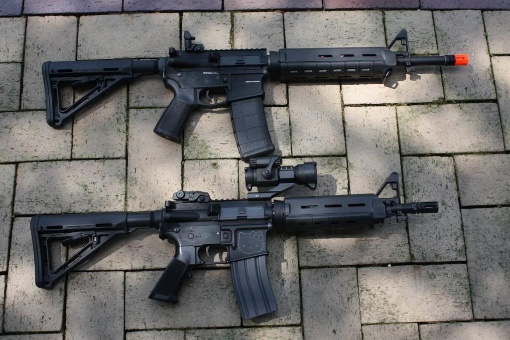

The BOL 1400mAh 11.1v LiPO will easily fit under the magpul handguards.  The NanoTech 1500 20c is a tight fit.  11.1v just spins the motor faster and trigger response is claimed to be quicker.  Only reported problems are high capacity magazine dumps which heat up the motor and gearbox.  If you're simulating your M4 Carbine you know the maximum sustained rate of fire should be kept under 12-15 rpm.  :)
If you're happy with 350fps or under then the short barrel has the advantage of size but unless your AR15 (I assume it's not a real M4 Carbine) has a 10" barrel you defeat the realism part of gun handling.  The 14.5" aeg is much closer and you can fit this barrel on your AR15 if you're willing to permanently affix the flash suppressor.
All about the same overall length:
16"
16"
14.7"
14.5"
Comparing the AEGS:
RM4 (top) 14.5"
KM4C 10" (bottom)
The 10" barrel cheats you out of some handling training, your 16" AR15 carbine is another 1.5" linger than my M4.
KM4C (top) 10"
M4 Carbine 14.5" bottom
Edited by Chuck S, 20 June 2014 - 02:15 PM.

At the moment I'm leaning towards the MOD2 and then getting some kind of QD fake suppressor so I can transport a short AEG, and then attach the "suppressor" when I get to the field to get a realistic length.

A "can" on the muzzzle will bring the overall length out to your 16" AR15's barrel easily.  And unless you're using a "mid length" gas system (like the RM4 and pair of LWRC carbines in the first photo) the sight radius will be constant as well.
