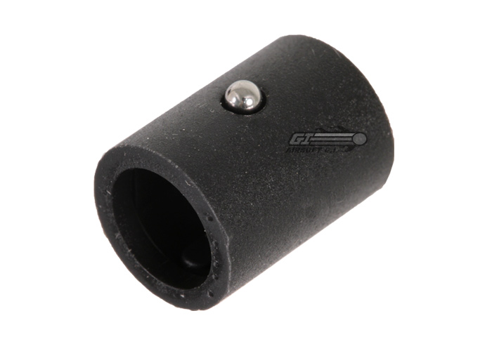

->Boobiegbb Double feed Mod: Link instead of the mod proposed by him, which was dremelling the barrel to put a o-ring to prevent the hop from moving, i just put some adhesive tape to make the step enough to keep it in place; it works perfect and don't need to modify the barrel.

Be sure you have the USA version or the KSC version2 hopup, the hopup, bucking and barrel are different from KSC version1.
Version1 are those who have the ball bearing system
Version2 are those who have the tensioner arm system
I have the version1 but i replaced everything so now is running version2 hopup, with RaTech barrel, and original KWA-USA bucking and hopup housing.
If you have the version1 and buy the version2 barrel it won't fit into the chamber and is the same at the other way, if you buy the version2 hopup but you have the version1 barrel it won't work.

As i said there are 2 versions of the asian lm4, the bearing and the "revision" with the tensioner, before buying anything disassembly the gun and check which one you have; if its made after 2013 it probably have the new version hopup.

->Boobie's double feed mod: Link instead of the mod proposed by him, which was dremelling the barrel to put a o-ring to prevent the hop from moving, i just put some adhesive tape to make the step enough to keep it in place; it works perfect and don't need to modify the barrel. DO NOT USE any kind of tape. I believe the reason is discussed in the mod thread. The short explanation is that the tape with degrade and could cause more damage.

The "strike through"s are unnecessary. Between the RAT barrel assembly and ESD EVO II, you have all the best part currently available for the LM4 (and KSC M4). That combination will also make sure there are no compatibility issues.

I didn't want to "dremelize" the barrel, that's why i used some tape, it works perfect and stays in place, this is how i made it:
The tape is not over the brass piece is behind it, it keeps it in place preventing the barrel form moving and causing double feeding.
