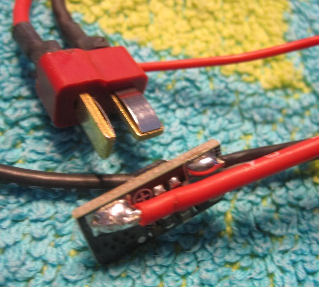

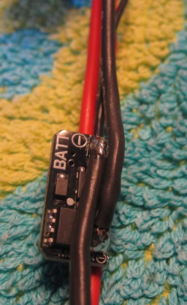

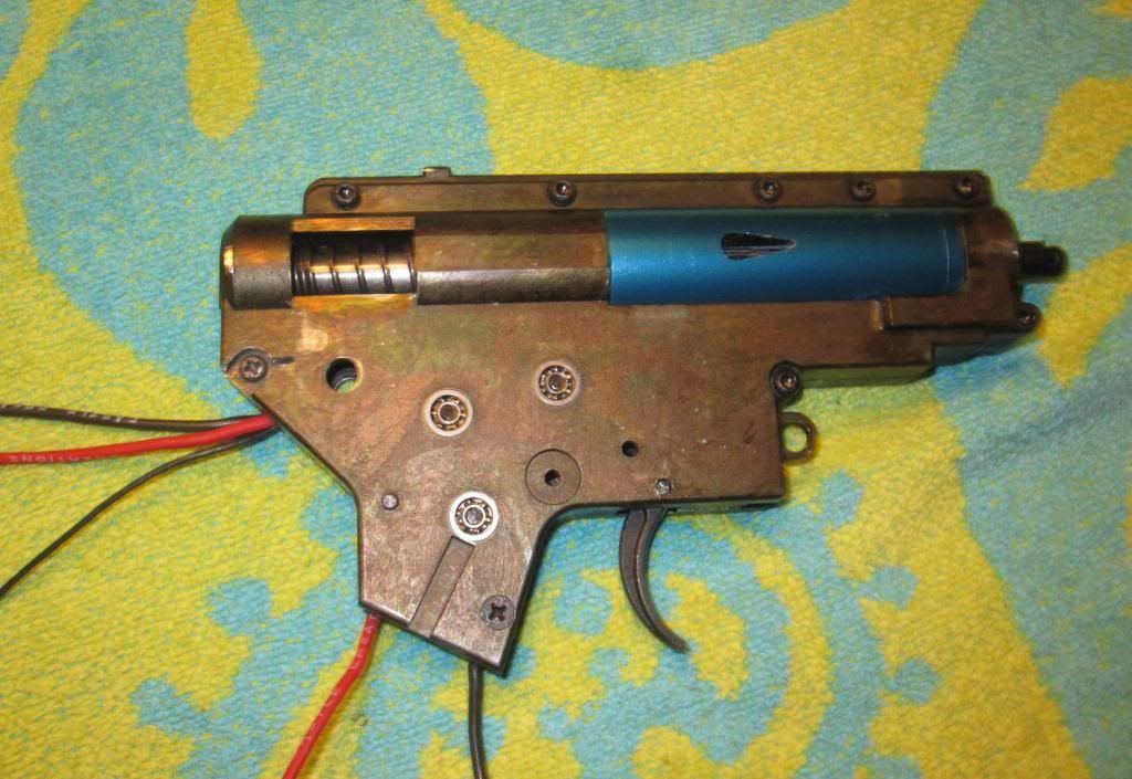

The gearbox wiring looks like this, three on the left go to the mosfet
Thats a GB for a different KWA, his 11.1 is in a K4 RIS with a ported piston Full metal rack, POM head and KWA M130 spring no Fet.
Using this motor he gets a high ROF
http://www.airsoftgi...oducts_id=16024
This is a fet left in one gun Pico AB fits in the tube with battery
HTH
