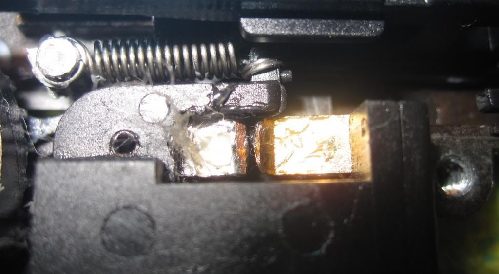

Oh ok. What about a mosfet? Can i go without one for a couple weeks? without it, I can get trigger arcing. can I not get trigger arcing if I pull the trigger quickly, and firmly?

KWA trigger contact is well built yes you should be fine

I been removing my mosfets, just my choice.
KWA trigger switch with Tamiya switch lube (prevents arcing) used with lipos
With the lube removed no arcing (looks new thousands of rounds)
NonKWA trigger switch, no lipo no lube lots of arcing
Edited by tales, 02 June 2014 - 05:47 PM.

Another thread with pics of KWAs trigger
http://www.kwausa.co...showtopic=12482
