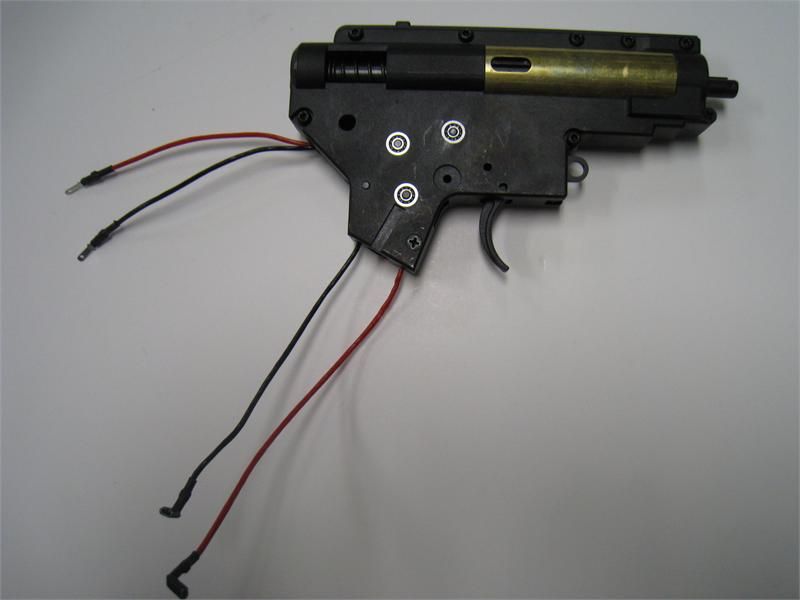

#17 tales
tales
  • 588 posts
  • Location:Brooklyn NY
Posted 30 April 2014 - 04:34 PM
View Posturiahskates, on 30 April 2014 - 03:25 PM, said:
Someone correct me if I'm wrong... I'm pretty sure you have to open your gearbox and get different wiring. Along with that I think you also need a mosfet. (not sure if it's actually needed or not). If you don't know how to get to and open your gearbox, go on YouTube and look up "KWA SR10 Gearbox Upgrades" or something like that by a guy named 808Kameleon. That's how I learned when I first upgraded my gun and he really walks you through the process.
Remove the crane stock  and buffer tube, you will find the wires that exit the gearbox.  No need to open the gearbox to remove the crane stock wire harness (coiled wire) and fuse. If you want to install a mosfet with AB you need to rewire the gearbox.
The wires on the left are visible when the buffer tube is removed
