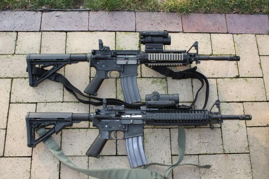

Here's my LM4 pictured with my working carbine (a LWRC M6A1).  I hang very little on the rails (there's a light on the other side).  M68 COO (Aimpoint CompM4) on both guns.
Only modifications to the LM4 are the sights, railed handguard, and the law enforcement/training high power bolt inside.  Both guns wear M16A1 pistol grips.  Both systems do well.  I don't shoot three-gun or other events but like to remain current with my carbine skills.  I can shoot a couple hundred rounds off my patio every night after getting home for hardly any expense.
None of the airsoft guns completely mimic the M16-system as there's no extractor.  It's possible to double charge the gun and try to cram two BBs into the chamber which then often jams the gun.  Green gas gets expensive too.
LM4 magazines are heavy empty or loaded.  You'll need a good loader.
If you don't need the bolt simulation the RM4 has some mind recoil that disturbs the sights just enough to require good follow thru. Since it's electric there's no green gas expense.
