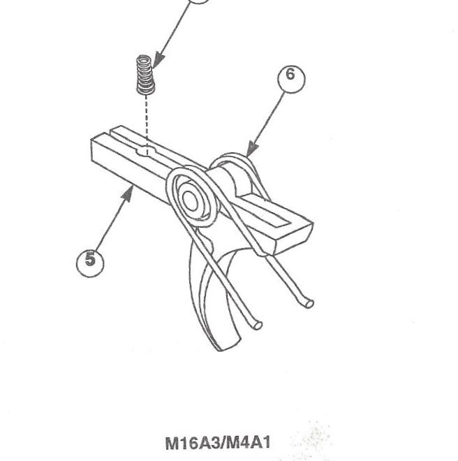

#7 Chuck S
  • 1,644 posts
Posted 22 April 2014 - 02:43 PM
LM4 trigger spring is #65.  Should look like this when installed.  Note the tapered sear spring on the tail goes in big end first.  Ignore the numbers, they refer to text in the military manual but the LM4 spring looks the same.
