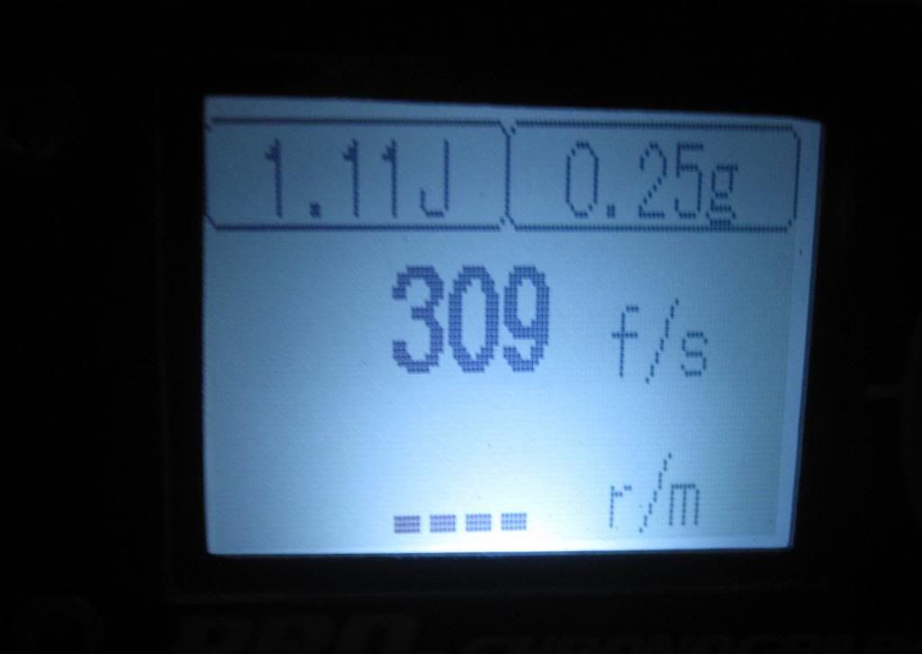

The stock spring is a KWA M120
Box stock SR7: KWA M120 spring: 309fps with .25s = 345fps w/.20s
SR7: KWA M130 spring: 330fps w/ .25s = 370fps w/ .20s too hot for CQB

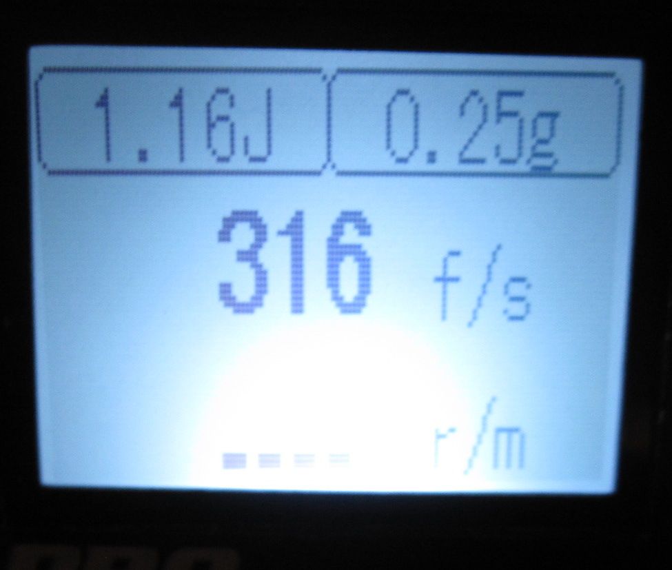

SR7: 6.02 355mm TBB, KWA M120 spring
KWA M120 spring: Slight increase in FPS with the longer 6.02 TBB.  316fps w/ .25s = 353fps w/ .20s good for CQB
