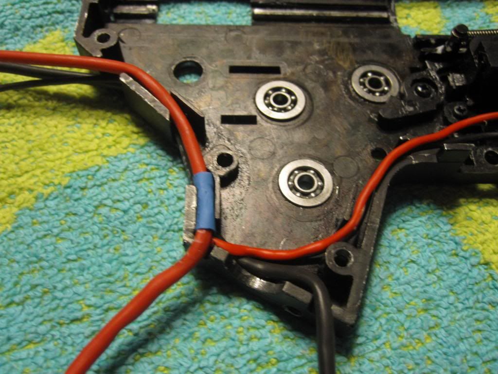

KWAs V2 gearbox uses a V3 spring guide, the spring shouldn't pop out.
This cured my overspin. Page four:  "Installation of PicoAB with replacement wires"
http://www.jbbguns.s...b702-picoab.pdf
Trigger bypass: Red 20AWG wire on right has a 20AWG black under it. This is connected to the trigger switch, the 20AWG is spliced into the 16AEG battery/motor wire on the left. This leaves three wires exiting the gearbox into the mosfet instead of four.

#9 tales
tales
  • 585 posts
  • Location:Brooklyn NY
Posted 30 January 2014 - 03:15 PM
View PostJesse Hammil, on 30 January 2014 - 03:14 PM, said:
Nice,  thanks guys.
Yeah, it stopped the overspin.
