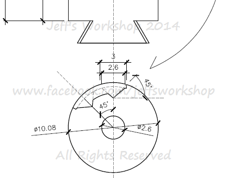

Sneak preview of my next project...

Are you designing it to fit stock LM4 ball-shaped detents? Or just the "pointy" detent that you use?

Because it will be machined in such small quantity, each selector centre can be customised.
For the prototype, it will be made for the 45° point detent, as it provides the most positive selector position retention. Subsequent production will most likely be made for the round tip detent, as it requires no modification for the end user.
Because the angle of rotation from Safe to Fire is so small, touchy and un-positive position retention can be dangerous to the end user. If testing shows that no significant wilful force is required to bump the selector from Safe to Fire, the round tip detent variation will not be produced, and a modified detent will be included in the package.
This selector centre is designed for and will only be PTS Mega Arms MKM compatible. The LM4 has a much wider lower receiver dimension, and a different selector detent location.
With all the above said, the project is still in drawings. It will be machined from stainless steel, with the possibility of a polished or silver sand blasted finish. The BAD A.SS/CASS selector levers will need to be purchased separately, which this centre is designed to work with.

Looks really good man. I'm very interested to see how it turns out. Unfortunately, I guess I will just have to wait until PTS releases their version. I don't plan to replace my Magpul lower anytime soon.
