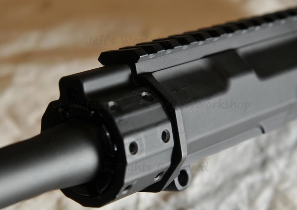

Multiple sources representing PTS claimed that the metal reciever of the PTS MA will be "Hard Coat Anodised". There was not even a hint of uncertainty. as it turned out, No. It is not hard coat anodised. In fact it wasn't even anodised. The paint on the MA looks exactly like the ones applied to the KWA LM4, and certainly just as flaky. I will be arranging for mine to be anodised in the near future. The only anodised part on the gun was the keymod rail.
Also some casting imperfections on the receiver can be seen in forms of small dimples on the surface, which are trapped air bubbles during the rough casting process. Hopefully they will not affect the integrity of the receivers.
The barrel nut on the MA is proprietary, and Yeh-Kai loves to thread-lock nuts, so without the exact tool designed to fit this nut, you can kiss the thought of upgrading the inner barrel and hop-up bucking yourself goodbye.

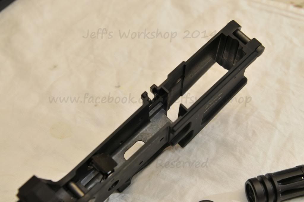

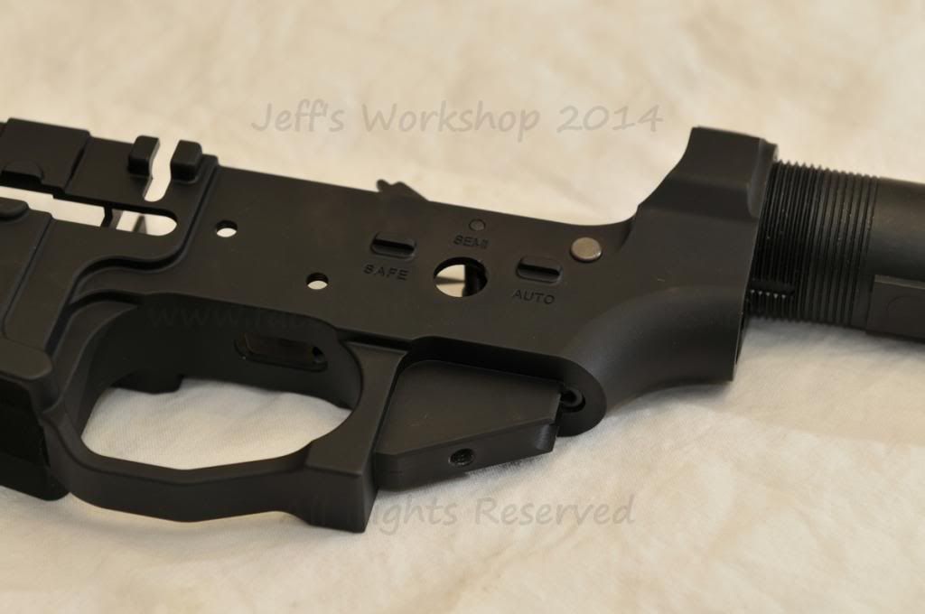

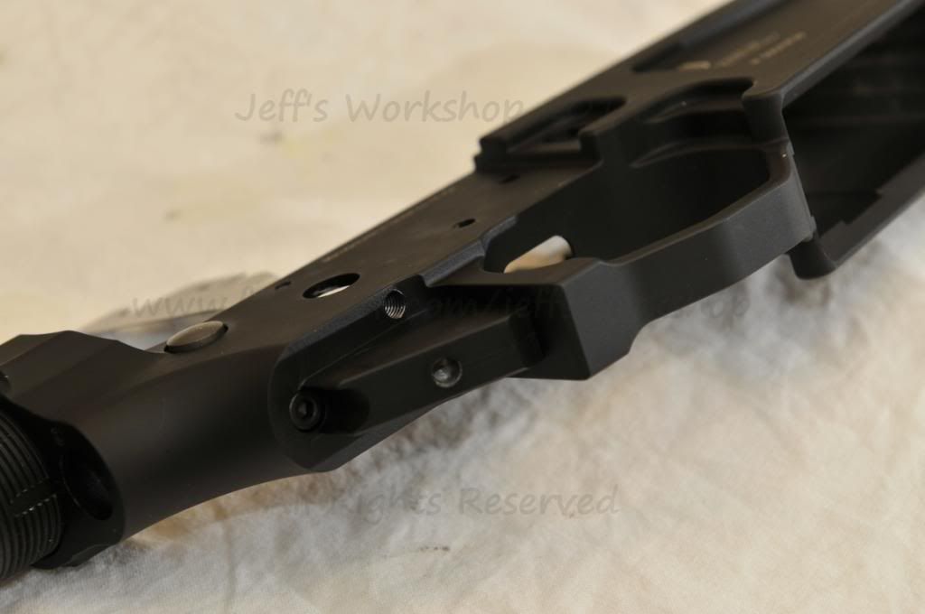

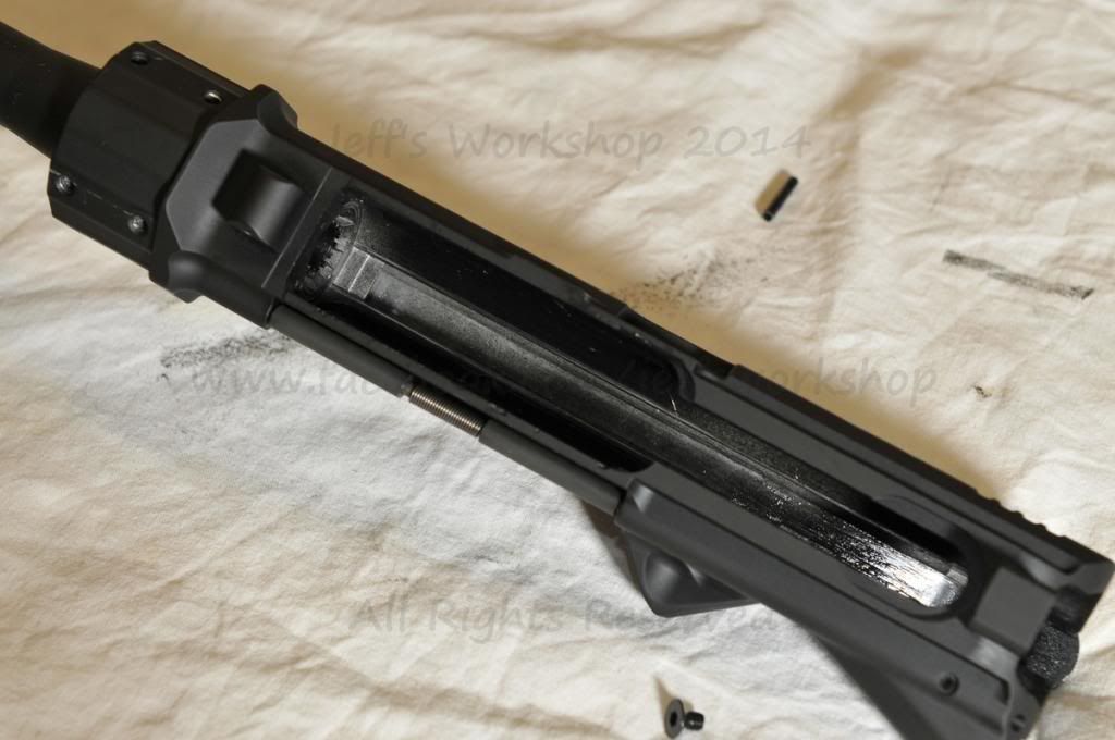

The triangle that attaches the pistol grip to the lower receiver is now part of the receiver, and not a separate piece that tends to cause the grip to not attach securely. The fire selector detent is now located at the correct place relative to the real steel.

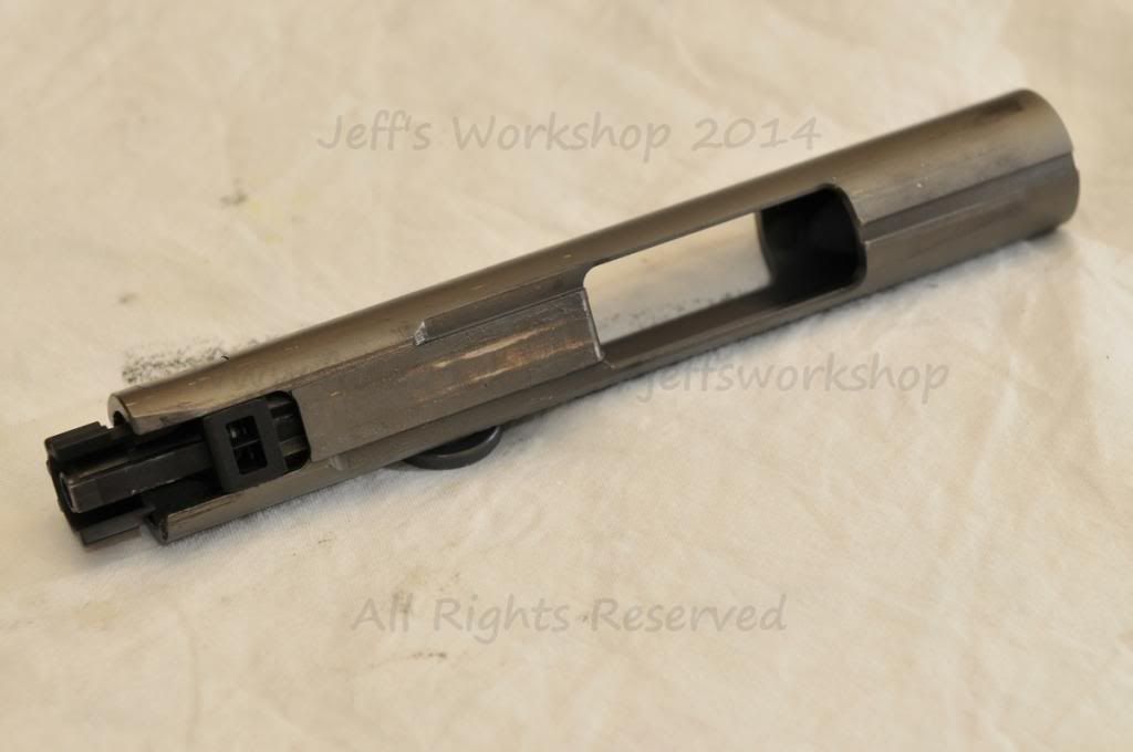

Those of you with the KWA LM4 will be please to know that the MA bolt carrier should be backward compatible. The incompatibility I claimed earlier this month seem to be the fact that there will not be different versions of the PTS MA for North America market and the rest of the world, and those with the KSC M4 will therefore have BCGs that are indeed incompatible.
The upper receiver is now ONE PIECE!!! WOO HOOOO!!! About damn time.

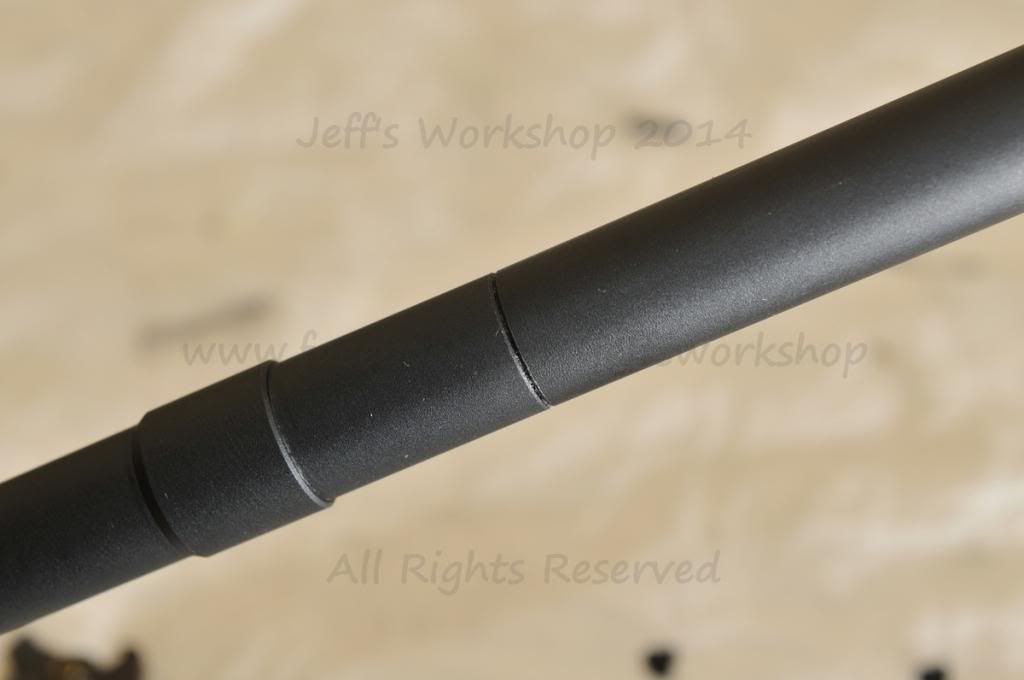

There is a joint on the outer barrel that seem to be pretty well thread locked. With enough strength, heat, and will-power, you should be able to separate the two parts of the barrel for your SBR setup.

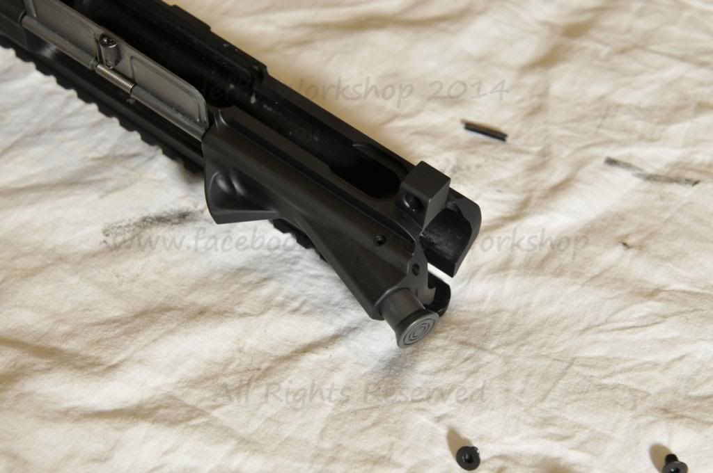

The Hop-Up adjust and system is the same as the LM4. The barrel extension is part of the upper receiver, and will not be removable.

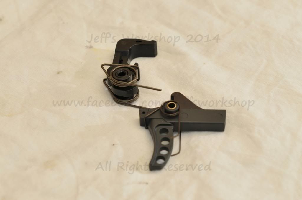

The PTS MA trigger feels lighter, with a clear second stage. However the first stage travel will need a little breaking in before it will return to its default position when you let off the trigger. The hammer seems to be identical to the LM4's.

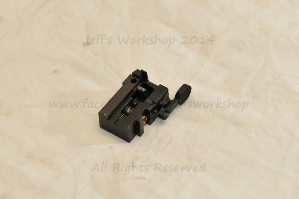

Not sure what this assembly is called, but it is identical to the LM4's. The bolt stop is the new version, which allows power-stroking to send the BCG home.

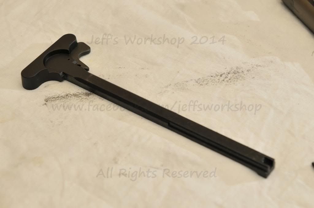

The Charging Handle is identical to the LM4.

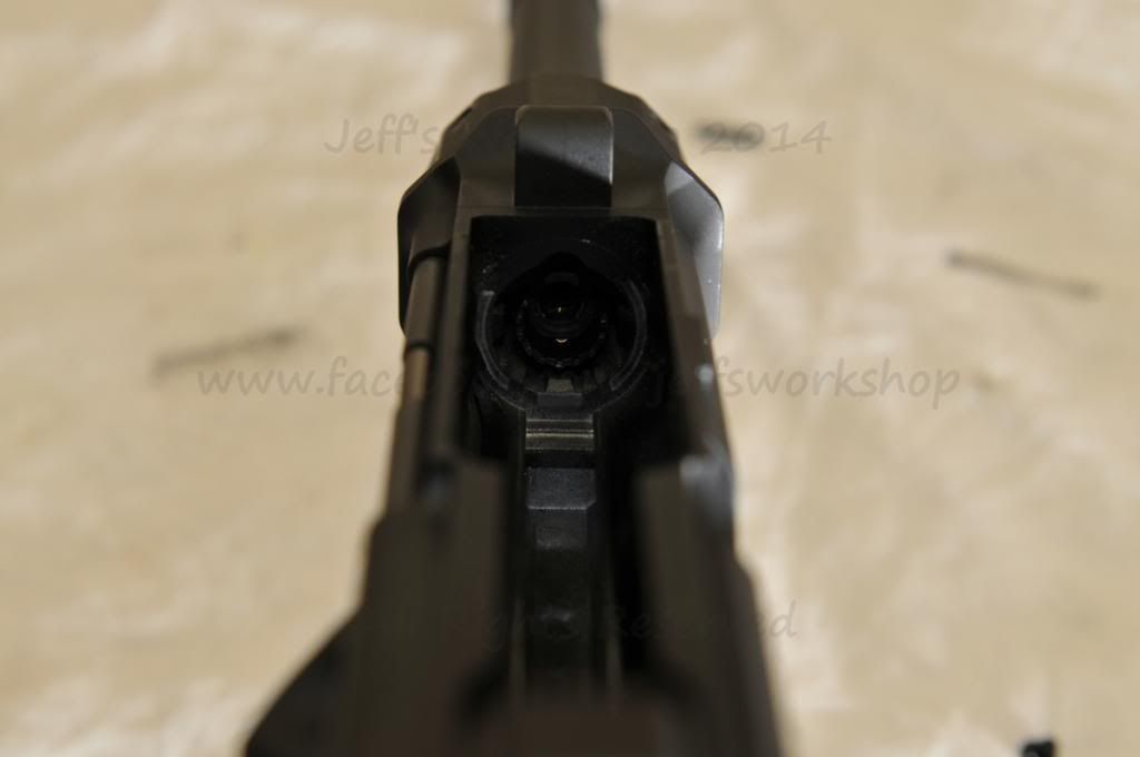

The loading nozzle and valve assembly is very similar to the LM4's, however if you look closely, you will notice that there is a flat divider at the gas intake opening. This seems to prevent the jet valve from drooping at its resting state, as to maintain a consistent gas output volume.
Interesting MA design, where the eject port dust cover hinge is installed from the rear of the upper receiver, and is held in place by the forward assist stay pin.

Thanks guys, I'm inclined to say that they are not compatible with the LM4 lowers, as was mentioned a few times by the PTS crew. However I could not confirm that myself as I have no access to an US version of the KWA LM4 on hand. From the looks of the MA upper and lower, and how different they look compared to the LM4, I would agree that in my opinion they are incompatible except those parts mentioned previously.
As to what is steel and what is not, I believe everything is the same as the LM4, except for the fire selector detent which has been made out of steel instead of pot metal, a good upgrade on an heavy wear part. The forward assist, trigger, fire selector, magazine catch, charging handle, buffer retention pin, firing pin etc. are all still pot metal.

I feel like a total idiot. After looking at your pictures again it's obvious the MA upper will not fit standard lowers. The rear tab is square like the RS, whereas the LM4 has a round tab like the front. It might just be a matter of shaving it round to get it to fit standard lowers.

I have a question regarding the outer barrel: Where you able to open that mid-way thread lock?
Is the thread CW or CCW?

I was actually able to. The thread is CCW. Liberal amount of clamping force on the outer barrel with some heat on the joint was required for me to release the threadlock.

With that testimony I gathered courage and tried again aggresively.
Extensive use of heat did the trick, and though I did do some minor damage to the removed portion of the barrel, the rest of the gun was unscathed.
