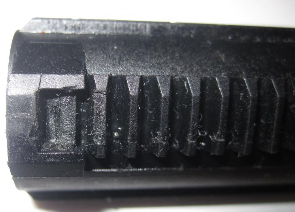

What does the piston look like after a year? I like the full metal teeth on high FPS guns.
This is my KM4 RIS stock piston with a Guarder SP130 after 11 months. Looks brand new
This is a MOD2 stock piston,  KWA 120 spring after 4 months.
The 1st tooth is grinded down. Im going to open it next week to install a fet ill post pics of the piston & gears to see if there is any damage.

The MOD2 appears to be cycling to quickly for the spring being used.  Basically the sector comes up and grabs the piston before is is fully forward.  There are 3 fixes:
  • Slow down the ROF
  • Increase the spring tension
  • Lighten the piston (or lighter piston)
Note:  Replace that piston before it shatters!
The RIS with the SP130 has compensated for the sector cycle or you have a slower ROF or both based on the top piston.

gcw, that was what it looked like the first time i opened it from the factory, it was shooting 303 -327FPS. I don't use any of those pistons. Remember how many cylinders i tried to get the MOD2 to shoot around 350FPS
I ended up using the G&G blue cylinder, ORGA 105 spring, Azimuth cylinder full metal, POM head (pic the 2nd post) & it shoots around 340FPS with .20 The Angel cylinder was sharp.
Used the blue, the others were over 380FPS with .25

My piston will look like your second picture...just no cracks. To be honest I never do anything to my motors....never had motor problems.

Most likely me when i open it up to install the fet.
Since i added a lighter spring, the KWA spring was too hot for Stryker.
The piston and POM head might be the same weight
Im using a HT motor Lonex A2
What should i expect, its a 14 tooth piston?

Thats pretty good for all that play after a year. I was amazed at the RIS piston i thought it would have been destroyed.
All my sons non KWA guns the pistons get ripped up in no time.
