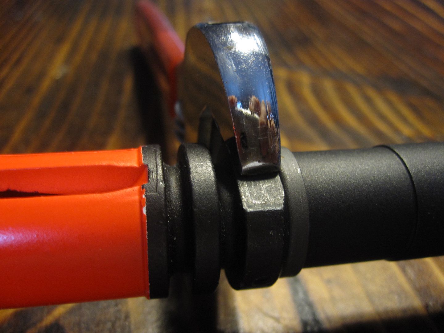

The flash hider has two flat spots for an adjustable/open end wrench. i removed he inner barrel, took off the stove burner grate placed the gun on a mappina with the flash hider over a low open flame, it came off in a minute I was next to the sink with running water

After the thread lock is heated a wrench fits the flash hider
If you don't have a wrench a ball driver through the flash hider also will work to unscrew it
