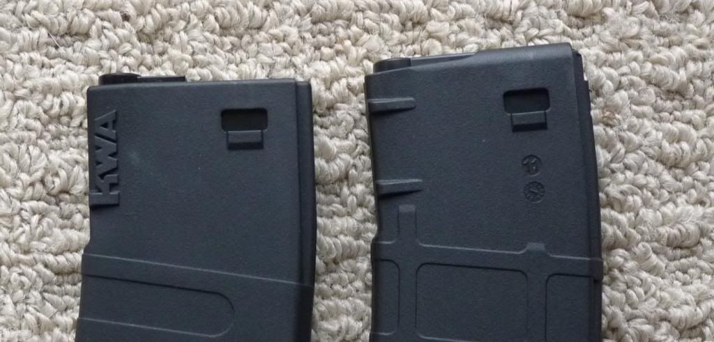

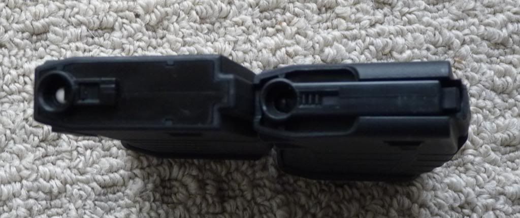

Here's a comparison of the top edge ("feed lips") of the KM4 (typical TM mag) and the RM4.  Note the extra area behind the BB feed lips on the RM4 magazine.  This prevents inserting it fully in a KM4 magazine well although the KM4 mag works fine in the RM4.  Call it backward compatibility.
KM4 (left).  RM4 (right).
