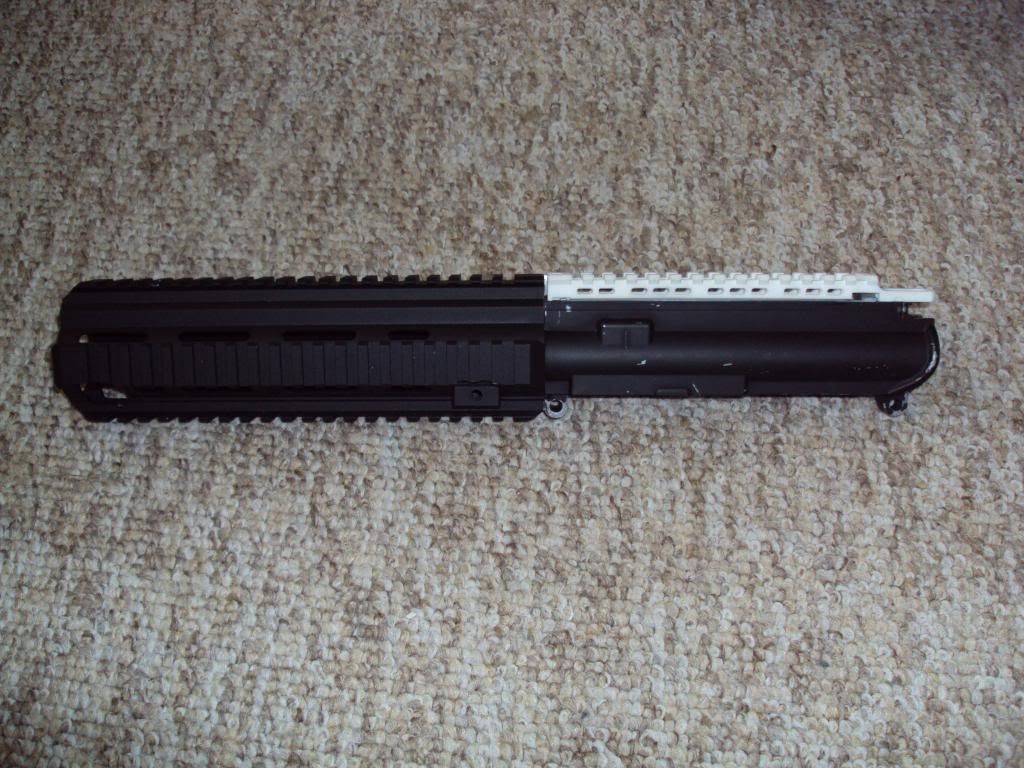

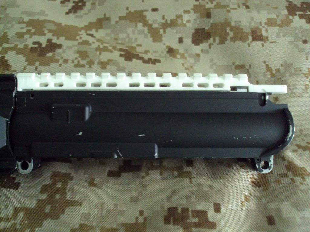

Barrel cover is on the Mod 0, all that's left is to JB Weld the top rail and paint the whole thing. Any suggestions for color/pattern?

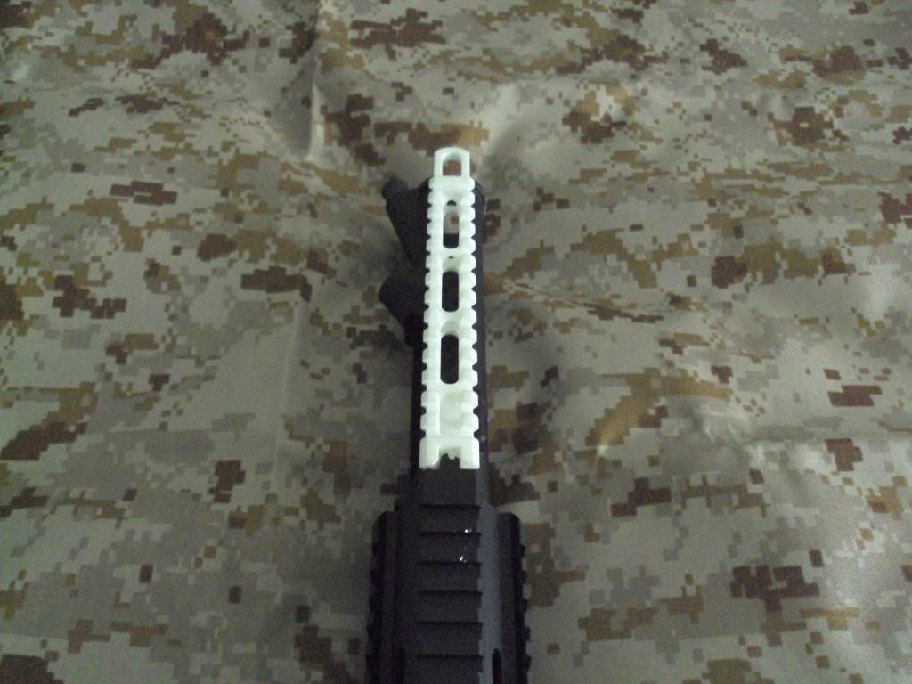

The 3D print prototype top rail has come in:
I need to make a couple tweaks. It sits about 0.5mm too far back and 0.5mm too high.I know what's preventing it from sliding all the way forward, but I still need to figure out the vertical issue.
Lastly, I've been considering a "Mod 2" which would have a completely custom one piece upper. I'm trying to decide if I should make it an exact clone of the RS or do my own style that's compatible with all the 416 components. In case there's an opportunity to get a small run of them made, what would people prefer?
