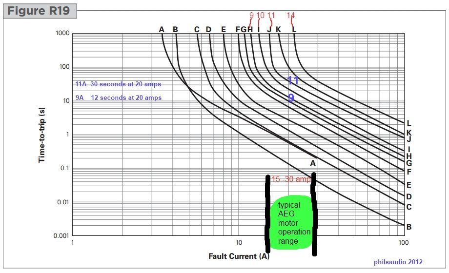

A fuse is a time sensitive device. The curve for your fuse will be something like this.
The current your AEG asks the battery for will be something like this. If you pause the player and move the progress bar you can see much more than you see while it is playing.
Your AEG is a dynamic system.

Thanks to both who answered!
The video showing really did a good job demonstrating all that I had been reading.
