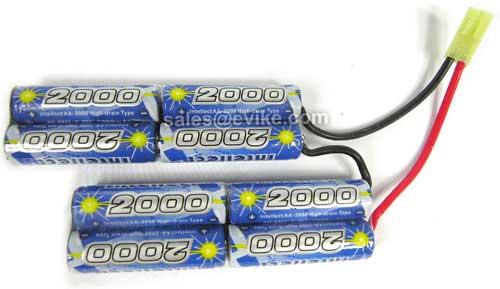

You should pick up one of these parts and a new battery.
Yes is will be a few bucks out of your pocket, but that is just the way it goes sometimes.
This will give you a back-up plan so that your gun always works when you need it and an extra supply wire for future use. The Parts I list will cost you $35.00 plus shipping.
Not bad, if you ask me.

Battery:
http://www.evike.com...oducts_id=24484
