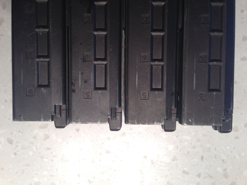

Hi sgtash, welcome to the forums. I would check the bb follower in the mag. If the notch on the side of the bb follower is worn, it may not be hitting the bolt stop up properly. If possible, could you take a picture of this piece so we can see if it's the culprit?

Thanks - been lurking for a while
Picture of the mags
Thanks for the help

BB followers look fine. Can you lock the bolt manually if you pull the charging handle back and push up on the bolt lock lever?
