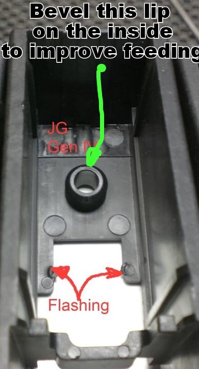

Posted 04 March 2013 - 07:51 AM
You can improve magazine compatibility by lightly beveling the inside of the mag receiver tube that contacts the magazine with a half inch countersink bit.
