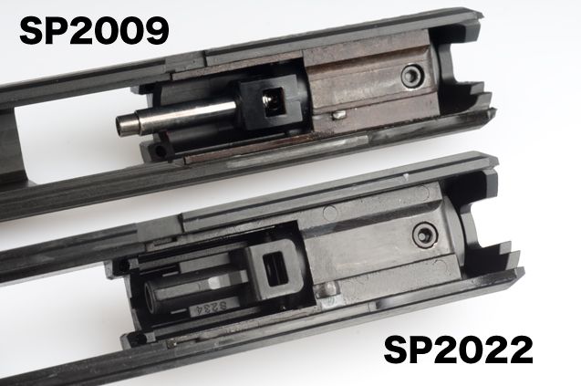

I'm posting an image between a SP2009, and an SP2022, both Sig (P) M226-style models, made by KSC back in the day. But, I do believe this was what the older system looked like for both KSC and KWA, compared to the current cylinder... Notice how the slide/nozzle assembly on the older generation used the nozzle itself to knock the bb in to the barrel, compared to the bb feeding arm on the updated cylinder commonly used today.
Sorry for the history lesson! LOL, but also notice the gas receptacle on the cylinder. On the updated version it is much larger and flat, on the older model it is smaller, and curved... not sure you can see it, but it is in fact curved.

Ok, now this thread is going somewhere. I have an old style usp with the described metal loading nozzle. It has the curved magazine gasket and port as well. So the newer design is similar to the marui, It has a plastic loading nozzle that loads the bbs.
