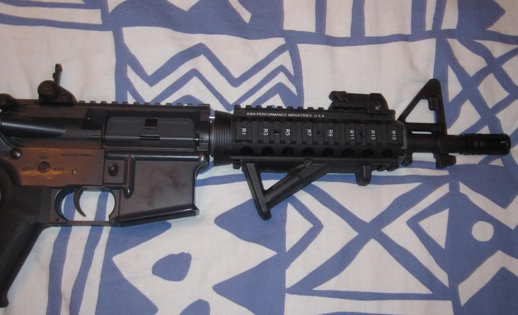

I did it because my son didn't like the battery in the grip. 7075 RIS was $18. It had the .5 cylinder that needs attention Now KWA uses a type1 cylinder i think. Along with the lower plastic receiver has been known to crack, mine did thats another $45+ for the metal receiver.
You're 100% correct its his gun, And he should have fun doing it :)
KWAs M4 RIS on a MOD2 he didn't like it

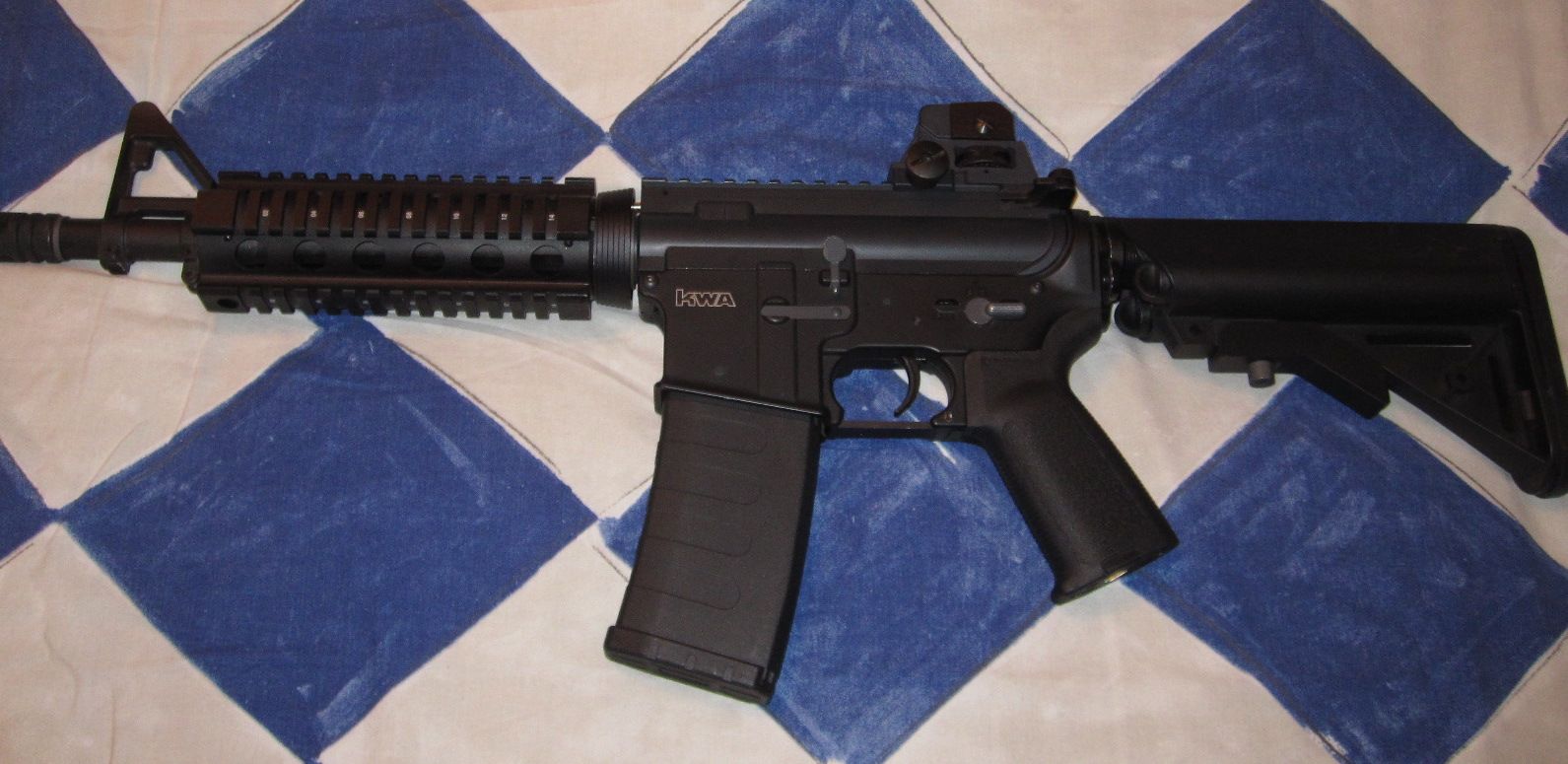

FWIW, the ST6 Echo1 is a great gun. Another one of his MK18s
