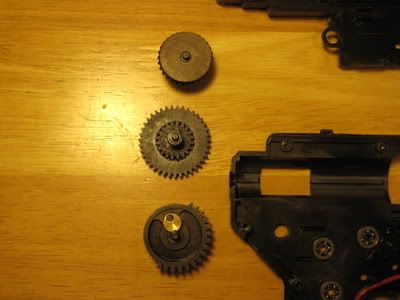

Yes, If you see the 3GX sector gear it has a "C" shaped groove going around the inner diameter.  The 2GX sector gears have holes drilled.  Both approaches are used to remove material to lighten and balance the gear.

The spur and bevel are better balanced as well.  Here is the pic of a gear set out of an M4A1 that was purchased last year.  It had the 3GX sector gear in it.
