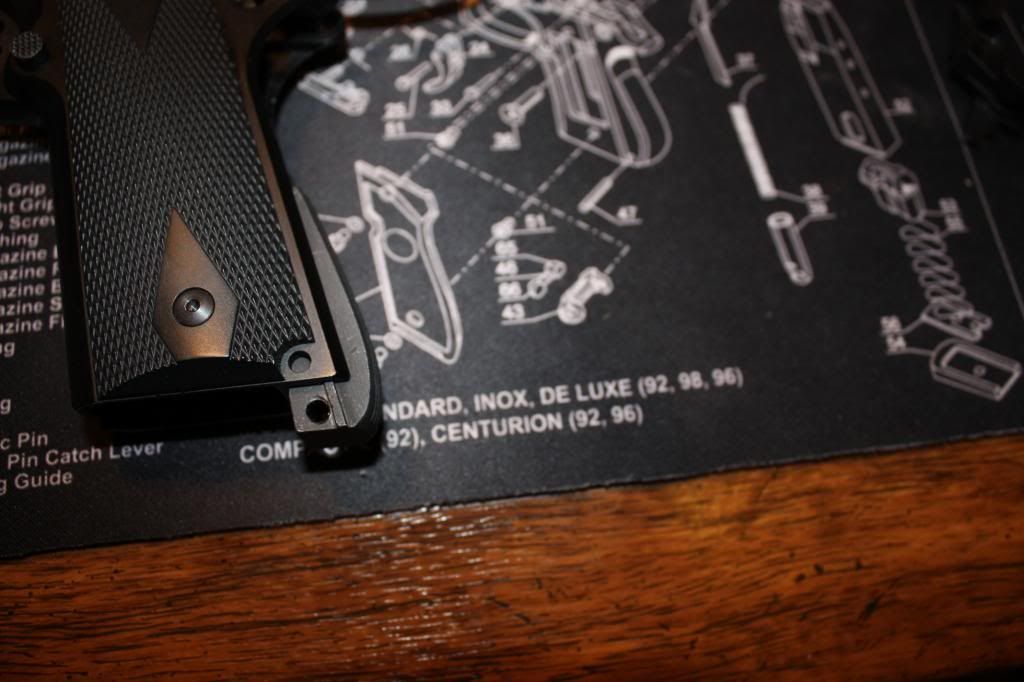

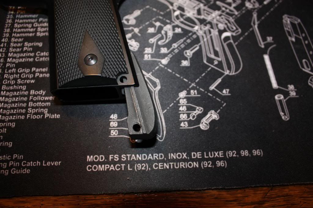

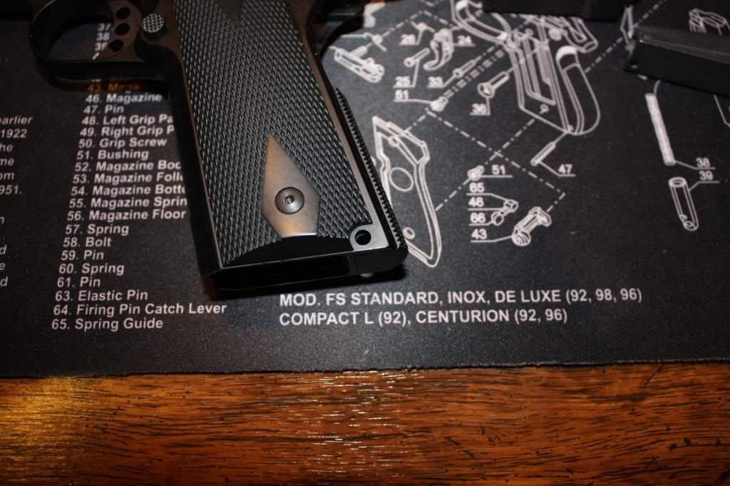

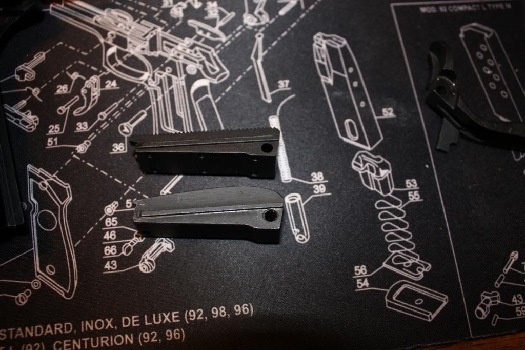

A M1911 mainspring housing (MSH) will not fit in the KWA Mark Series.  It may be possible to modify a M1911 MSH with quite a bit of work.  Here's some photos of my attempts yesterday.

Photo 3.  Here's why it stops.  Note the shape of the MSH at the bottom end in the 48, 69, 50 area of the Beretta mat :) :
Photo 4.  Differences between the two MSHs.  Note the area along what is the the forward edge of the MSH is much thinner in the KWA (top) version.
I tried several real M1911 MSHs with identical results.  I attempted to modify a plastic, arched MSH to fit with only partial success.  Requires more contouring to fit and secure the sear spring properly.  (I'll drop this in an envelope for you if you want to play with it more than I did.  PM or email me.)
BEWARE:  The KWA pistol closely mimics the M1911 internally but not exactly!  There are several extra parts that are positioned differently and the vital and nearly microscopic impact pin (#60) will fall out unless you take precautions.  The pistol will not function without this part.  To change the MSH in either the KWA or cartridge models with the least hassle follow these steps.

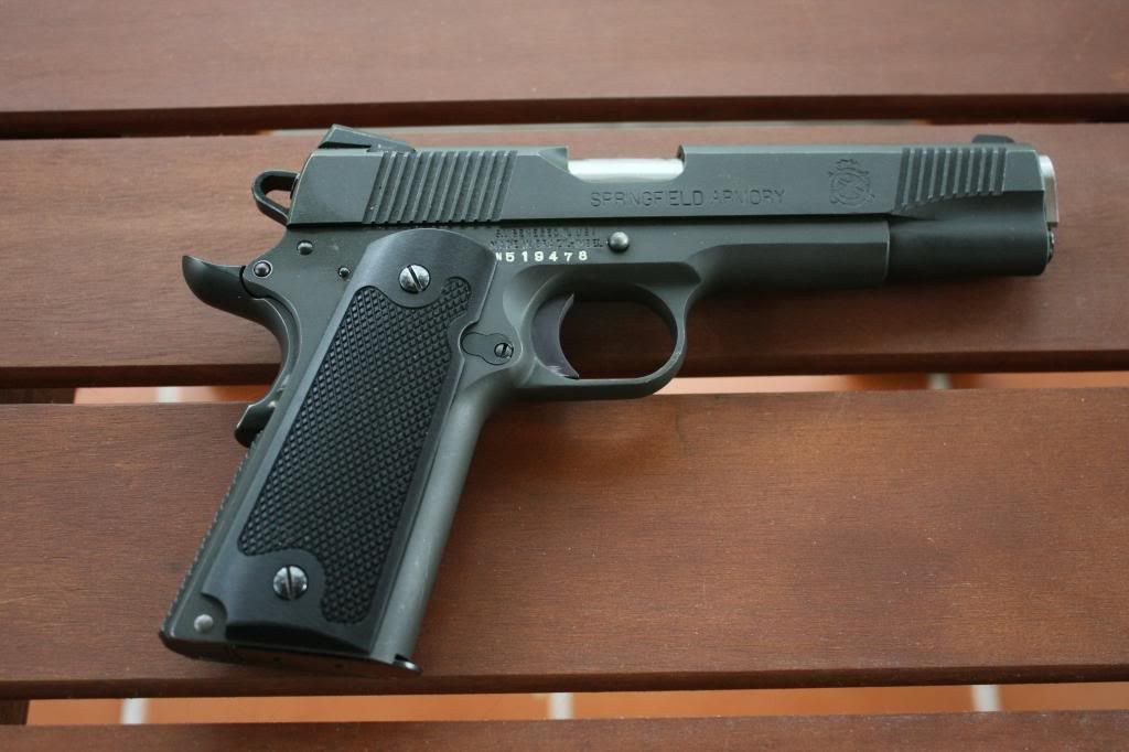

This is my (former) Loaded model with a flat MSH (probably an Ed Brown Kobra checkered), proper trigger, thin AlumaGrips, removal of right side frame safety. USGI recoil spring, guide and plug.  EGW barrel bushing.  It probably had Ed Brown extractor, sear, and disconnector as well, but it's been a couple of years.  :)  I regret trading it.  My Mark remains a good trainer.
