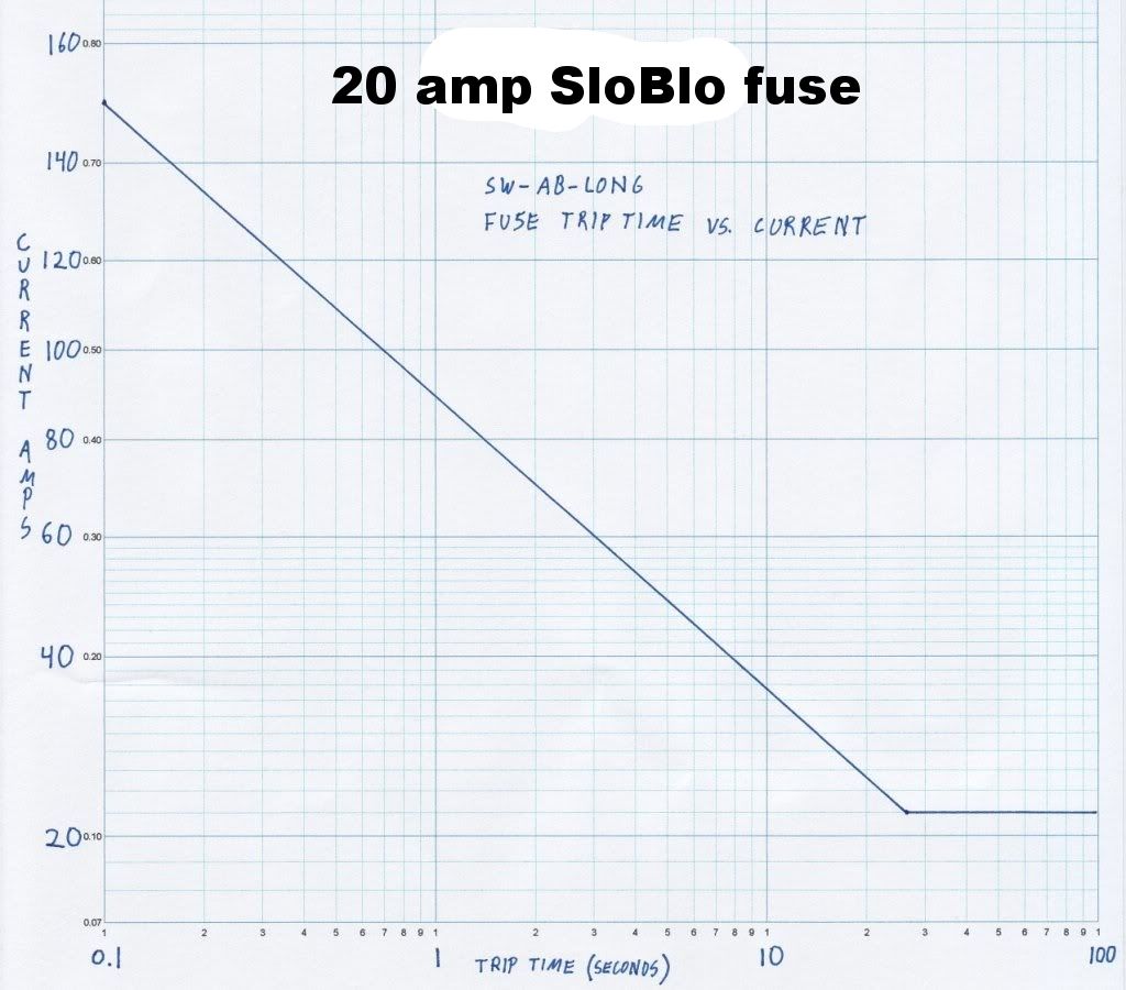

View Postga mercs, on 21 August 2012 - 05:02 PM, said:
that will work,,, i run a 2000mah 11.1v 15-25c lipo in my cqb and have not had any electrical issues as of yet .....over 100000 rounds.......i still dont understand the whole out of spec concept... i know what they are saying but it makes no sense ,,,,,you can lead a horse to water but you cant make him drink,,,,what i mean is the lipo that i run will technically  dump 30 amps constant and up to 50 amps in burst but the gun has a 20amp fuse that has not blown to date so if a 20amp fuse is holding the motor can not be drawing more than 20 amps ..please correct me if i am misunderstanding the concept
Your fuse could be letting in excess of 20 amps flow, for a short time that is, without blowing. The time to blow chart below can shed some light on that fact.
