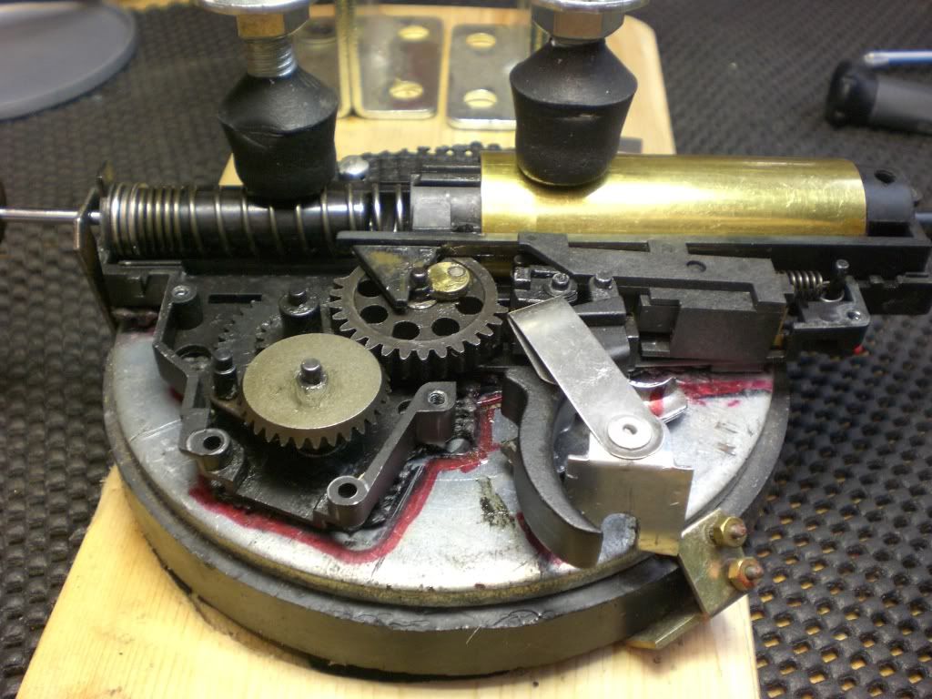

Here's a pic of how a proper angle of engagement supposed to look like.  Sorry I know this is not KWA but you get the idea. lol
this is how mine looked after my sorbo and before the piston stripped. The design of the KWA piston precludes actually seeing the gear mesh, even with the tappet removed.

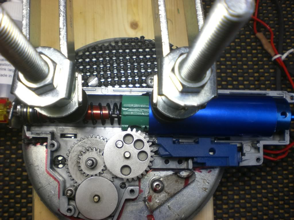

PS I know how to fix AOE. Here is another V3 box of mine

It is possible to have perfect AOE without removing the 2nd tooth on a piston and is evident in a KWA system.  And maybe I am not understanding you but are you saying that KWA cylinder heads do not come with sorbo pad that would adjust for AOE?
Also there are many other brand pistons that are manufactured without the 2nd tooth removed like CA, G&G, BRAVO, JG and etc that still works well when used in their GB's.  When I get my new KWA for a project this week I will take pics of the cylinder head and the AOE and hopefully it will clear up some confusion.
