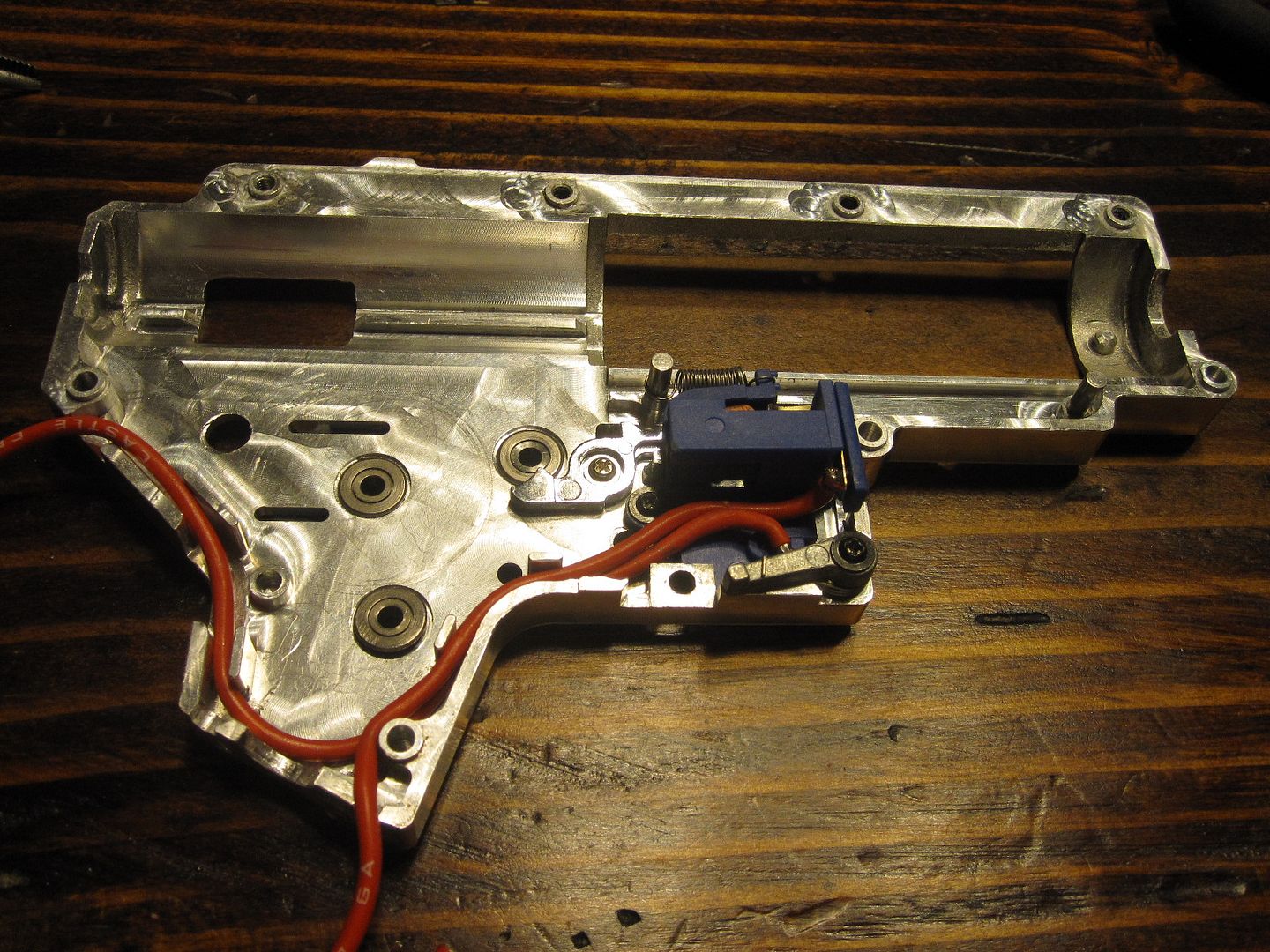

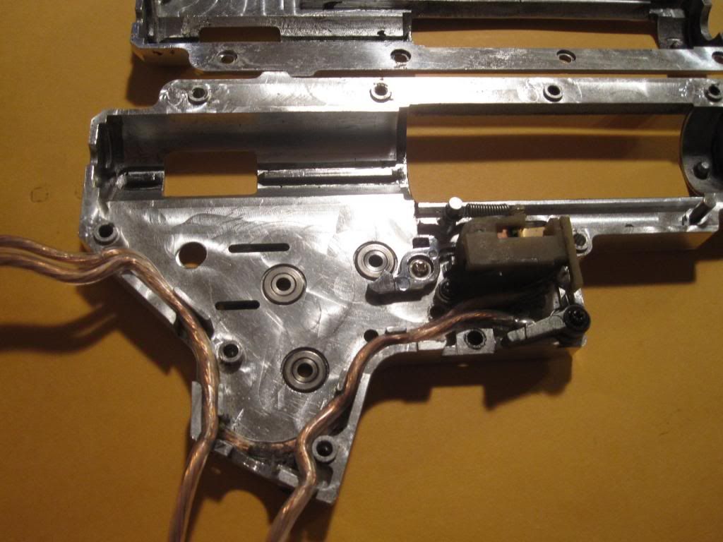

Tales: What wiring is this in your mechbox?
#14 tales
tales
  • 365 posts
  • Location:Brooklyn NY
Posted 01 January 2014 - 07:01 AM
It wasn't installed by me. Its Speaker wire.
I rewired the gear box using Castle Creations 16AWG http://www.hobbylinc...CFW9nOgodnEUAaQ
