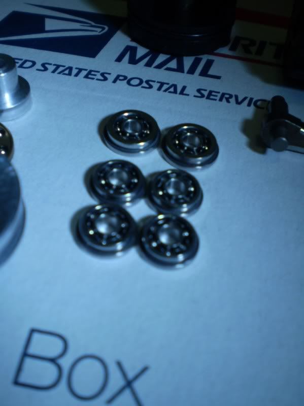

I found some time to strip my AEGs apart for a tune up since we are getting ready for a bivouac game.
1st tune up was on 85,000+ rounds and I swapped the stock spring to an SP130, used a Deepfire Piston body, stock spring guide to a Guarder bearing Spring guide and used Guarder piston head bearings with the stock Piston head.
A few mags later, I swapped the Guarder Spring guide and used the stock KWA Spring guide aswell as the stock KWA Piston body just to see how long this baby can last. The only aftermarket part left was the Guarder SP130 and the Guarder Bearings on the piston head.
The stock 85k+ round old Piston Body was able to stand 35k+ more rounds with an SP130.
Note that I have been using an 11.8v 15c lipo.
The switch assembly is intact! A few wear marks but could still take some more beating.
Normal switches burn even with a 9.6 nicad. This was used with an 11.8v Lipo.
Little wear on the gears. Id rate it 8 over 10
Stripped the grease off using gasoline. :rolleyes:
Bearing type bushings is still tight.
Piston head shows some wear. The bearings for the Piston head are from Guarder.

The KWA washer type spring guide shows how the spring rubbed against it. If you compare the wear on the washer type spring guide and the Guarder Bearing type spring guide, it shows that the bearing type would work better. Something KWA has to improve on.
Very little wear on the pinion.
Bevel Gear
Spur
The Sector gear had this crack on the fixed washer thing that i mentioned in the first tune up. It does not affect the AEGs performance in any way.

Airseal nozzle looks okay! I did test the Cylinder head/Cylinder/nozzle pressure and showed that it had no leaks.
Cylinder Head. Cylinder head nozzle wobbles a bit but no leaks. :blink:
Gearbox is in A+ condition! It snaps back on!!!
Some wear by the sector chip. nothing to worry about cause i think it ate its way thru so i just grease that part
The anti reverse shows some wear but is okay. The tappet plate is okay.
The first time i took the bushings out of the gearbox I had to mark where i took it from so i woudnt mess with how they were shimmed since there were NO shims! But I was surprised to put them back together (without marking them) and locked the gearbox to check and they were spinning like i spent 10 mins to reshim! Awesome precision crafting by KWA.
