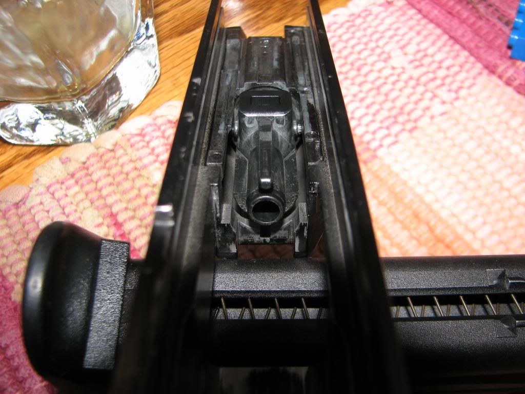

Hi awlogue - Welcome to the KWA Forums. Are the BB's stacking in the barrel ot getting stuck in the bucking?  Also, is the hop-up completetly off?  Also, any chance you can post a pickture of the loading nozzle?

Thanks! They are stacking up in the barrel with the most recently chambered round in the bucking as it should be. I'll check the hop up and post a picture of the nozzle in a moment.
Edit- Hop was completely off.

Thank you for the pictures.  The loading nozzle looks good so that issue is eliminated in my mind.  When the BBs stack up in the inner barrel will they roll out if you point it towards the ground?  Do you know if the inner barrel is clean or if it is an after market TBB?  Also, what BB's a re you using?
