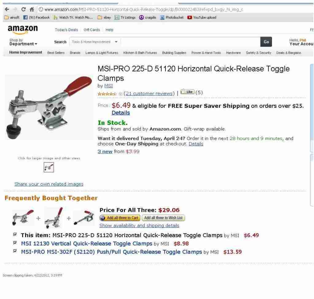

in one of your pictures you have what looks to be a bunch of clamps and stuff holding down your cylinder, your spring, your trigger, did you make that? if not where can i get one, that looks like it would lighten the stress factor of needing 8 hands to put a gb back together.
Funny you ask, I just posted that somewhere else.
Magnet from a broken musical instrument speaker, some screws into the holes that were already tapped, a board and some clamps something like these.
Then you can let your imagination fly.

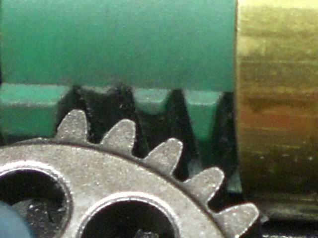

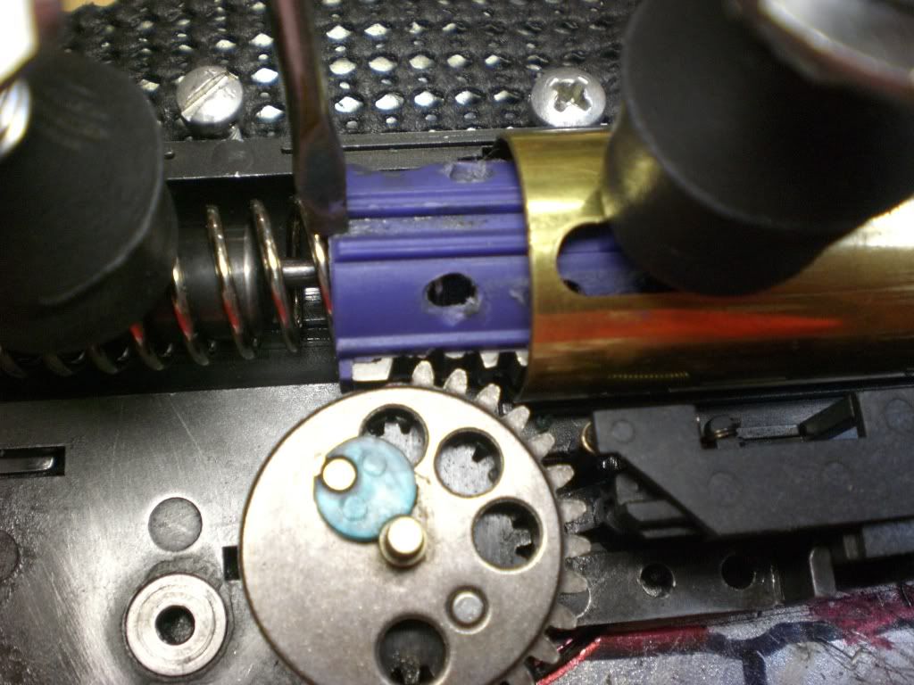

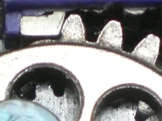

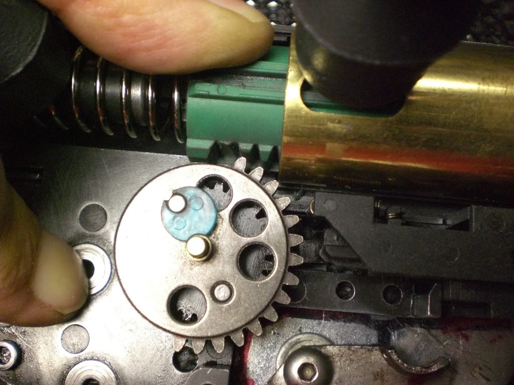

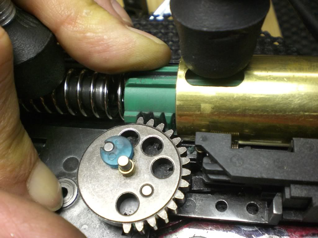

Now that AOE looks much better and it appears that the teeth are meshing much deeper. I would stick with green piston too since the AOE has been correctly adjusted your system should hold up for quite awhile. Good job on that.
And concerning TM specs, from experience I have learned to just deal with all these differences between each brands. I try to find good matches most of the time and sometimes end up just modifying parts to make it work. I just upgraded a Cyma AK for someone and I had to try 12 different nozzles and bucking combinations to find the best match. That was about $80 worth of parts that will just sit in my drawer. LOL
EDIT: Now that I had a second look, your piston is too far back.  It looks like comparing the before and after adjustment photos in your previous post that the piston seemed to have moved more than 2mm that I previously suggested.

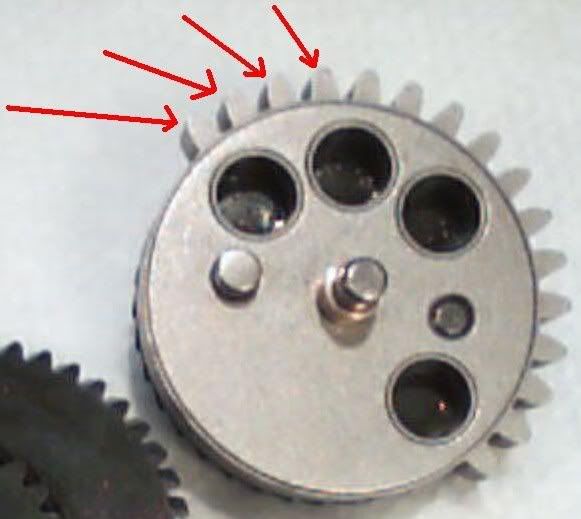

I have tried in the past removing teeth from the pick-up side of the sector gear but no success. It had the worst feeding problems and timing was difficult to adjust.
If you look at the siegtek dual sector gear setup you can see that there are less teeth on the release side and no teeth were deleted from the pick-up side.
http://www.siegetek....ons/cyclone.pdf
I currently have my SR5 setup where the release side teeth were removed and it shoots great with no feeding problems at all after the timing on the air nozzle was adjusted by removing some material from the "fin" of the tappet plate and cutting some coils off the tappet spring so that the air nozzle springs forward slightly faster.
Now in your situation you have already removed one tooth from the pickup side so to be honest I don't know how it would affect feeding if more teeth are removed now from the release side (which is what I would recommend).

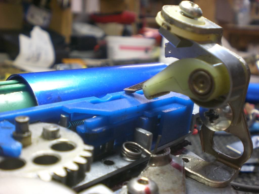

It seems the conventional wisdom of SS'ing from the PU side of the sector seems to be correct way in that it is much simpler when adjusting air nozzle timing.  It required no modifications to the tappet plate and the tappet spring.  I had a chance to work on my CQ-SR project today where I SS'd from the PU side by 3 teeth to test out where I might have went wrong in my previous attempts.  Previous failure seems to be a result of modifying the tappet plate when SS'ing from the PU side. This did not allow the tappet plate to be delayed long enough for proper feeding.  I am getting a consistent 377FPS at 35RPS using an SP120.  Tomorrow I will test range to make sure that bb's are not falling short but so far chrono testing indicates proper operation.
My SR5 on the other hand was SS'd from the release side by 4 teeth where the tappet plate "fin" was cut by half and tappet spring shortened by 2 coils.  This setup is just fine and I have not suffered from feeding issues shooting at 38RPS at 365FPS using a 11.1V 15C 1400mah battery.
So far I have concluded that both setups work fine but for the sake of taking the simpler route I would opt to SS from the PU side for future projects.  One thing I would like to test out though is with SS'ing from either side, what the MAX RPS would be before it starts to suffer from feeding problems where some more modifications are needed.
So in theory I could have even taken teeth off from both sides and this would still work as long as timing was adjusted slightly by modifying the tappet plate and spring.
