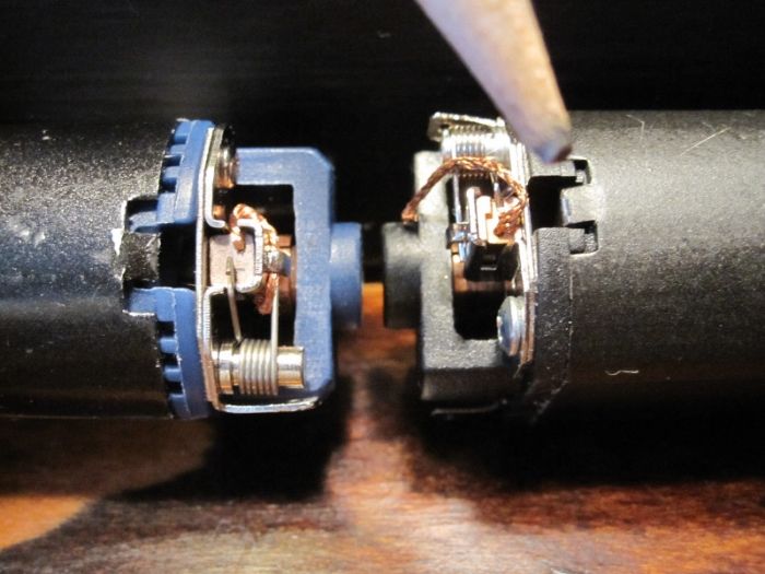

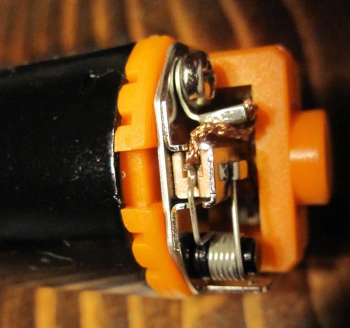

The failure of your current motor, if it doesn't smell burned. There is a good chance its in the brushes. Have you ever removed the brushes on a motor before?
The shunt wire (the wire that comes out of the brush) is wrapped around the spring clasp. Its common for the shunt wire or the spring to get hung up on the brush hood. There are slots on both sides of the brush hood: one is for the spring, the other is for the shunt wire. So they can move in as the brush wears.
Motore on left. You can see the wire & spring are in the brush hood slots.
Same here
There is a chance the brush cracked, when you remove a brush, its best to install it the same way it was removed.
Do one at a time and don't reverse them, turn them upside down. They wear different, so install them the way they came out.

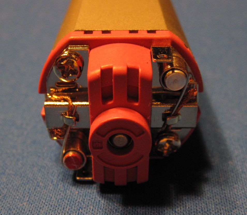

I have found some quality motors at good prices. $30+ shipping. They use a D pinion gear. That will save you money buying a gear puller & the quality is like SHS "D" pinions or close to it.
This: ZCI high torque.  Link

I think I said don't flip them because they don't wear even
I think the wire  or the spring got stuck on the brush hood where the brush goes, there are slots so as the brush wears the spring & wire can follow the brush into the commutator
(Copper thing the brush touches)
If the brush looses contact with the commutator
The motor won't run
When you reverse the brushes that leaves the pointed part of the brush to contact the comm first
That could break the brush
You can't switch the pinions kwa uses a round hole the zci uses a D shaped hole pinion gear with a set screw you won't need a gear puller like on KWA motors
Sounds like you got a lot of use out of the kwa motor if the brushes are that worn
It's time to replace something brushes or motor
In the future maintain the motor. a few easy steps so when the motors broken in you will get full performance
Also make sure the shunt wire & spring can't  get stuck on the brush hood
And reinstall them the way you removed them
I think the wire was hung up and you freed it when you reversed the brushes
Good luck!

The ZCI motor I just installed in a customers DMR pulls a MadBull m150 spring with ease.
This a linear spring and is actually SP rated though labelled M rated
I will be using this motor in my m170 KWA DMR build.
As far as Pinion gears, SHS are by far the best for the money.
They are built like a tank and mesh well with KWA gears and TM compatible gears.
They are my go to Pinion Gear.

Big fan of ZCI Motors.
Not a fan of their Pinion Gears.
One of my ZCI Pinion Gears just fell right off when removing the motor.
They also do not mesh perfect with KWA Bevel gears, but are not horrible in this respect either.
An SHS Pinion Gear is always a great choice for Pinion Gear replacement.
Be careful in Full-Auto with the ZCI Motors.
If your gun is not fully tuned to accommodate high speed you will most likely get pre-engagement issues.
This just happened to a previous customer of mine with his all stock, never opened up, KWA m4 after maybe a 1000 rounds on the ZCI HT motor and using a 11.1v/1500mah/15C Li-po.
I will be fixing his gun for him and doing a full-tune up on the gearbox this week.
