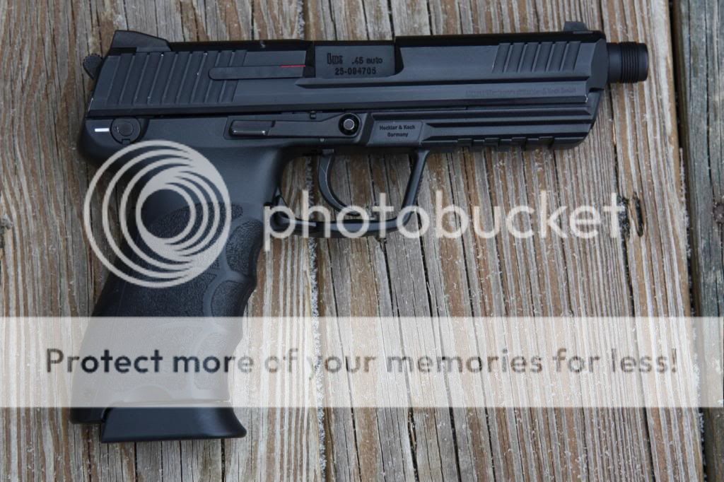

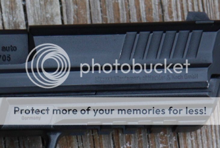

As you wish.  Here are two pics.  One of the full gun and the same shot cropped for detail.  Let me know what you think.  I only did a quick job but it seemed to do the trick.

Posted 02 February 2013 - 01:36 PM
Looks like a real gun! Lol..but really tho..looks awesome..good job
