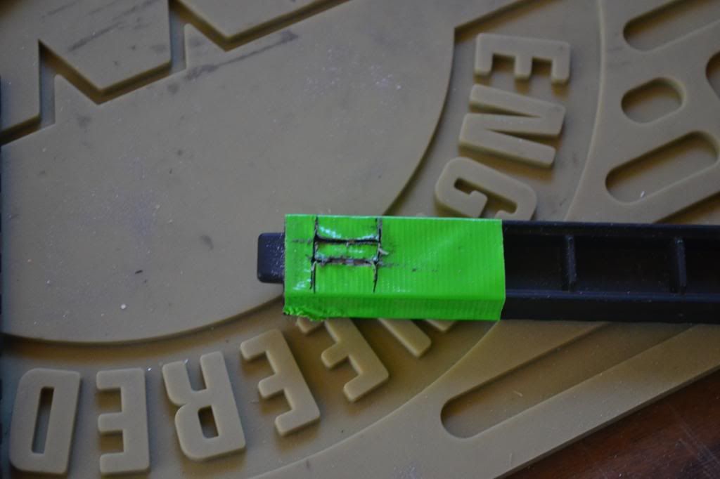

3. Carve out a space for the upper rail mounting tab. I used a Dremel cut off wheel the cut and grind the JG tab flat.
The JG tab before:
After grinding flat:
Marking off the dimensions and placement of the custom tab:

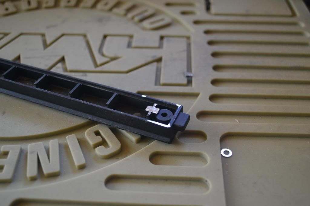

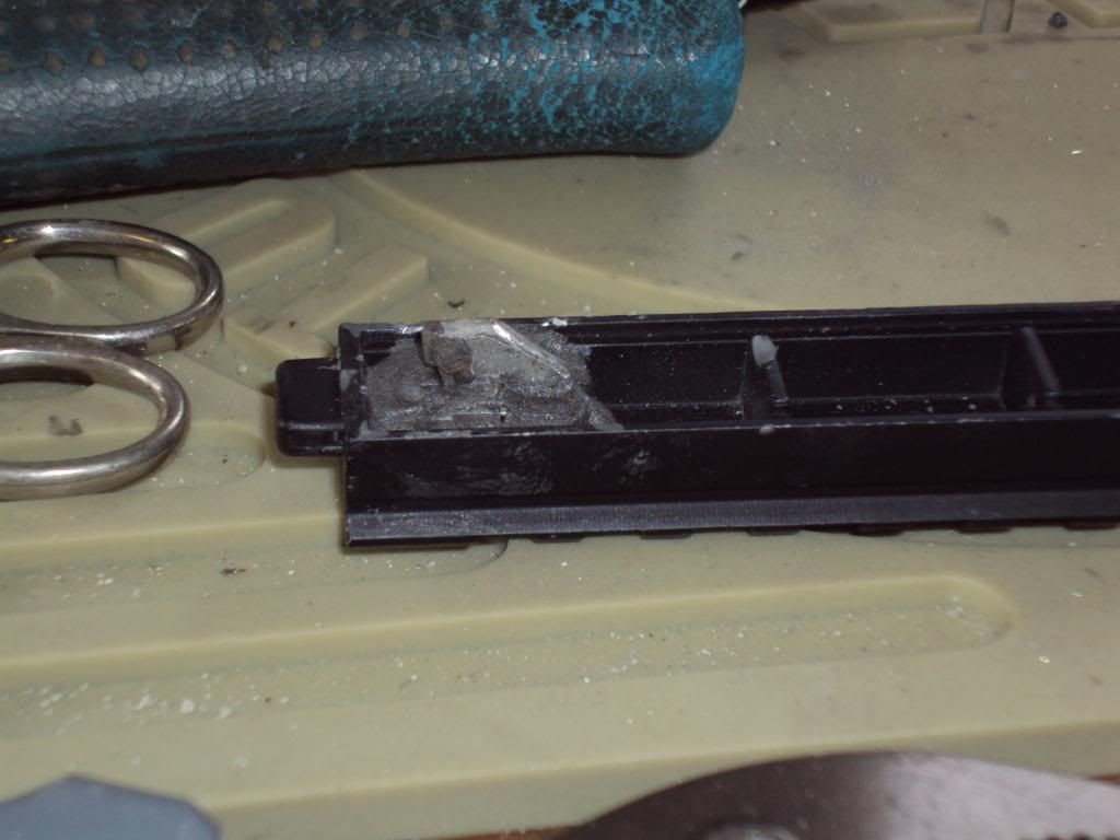

5. Bond new tab to JG rail. I used JB Weld SteelStik (http://www.jbweld.co.../j-b-steelstik/) and just put a sh*t ton where I hogged out the material and stuck the tab in. Before the epoxy cured, I mounted the rail onto the receiver and cycled the charging handle a few times. We want the epoxy to fill in the most space it can for stability, but we want to make sure it doesn't interfere with any of the functions. This will also make sure the tab is perfectly aligned. After checking to make sure the epoxy wasn't bonded to the receiver or the charging handle, I actually let it cure mounted on the receiver with the charging handle locked.
Sorry it's grey-on-grey, but here's the tab bonded to the rail:

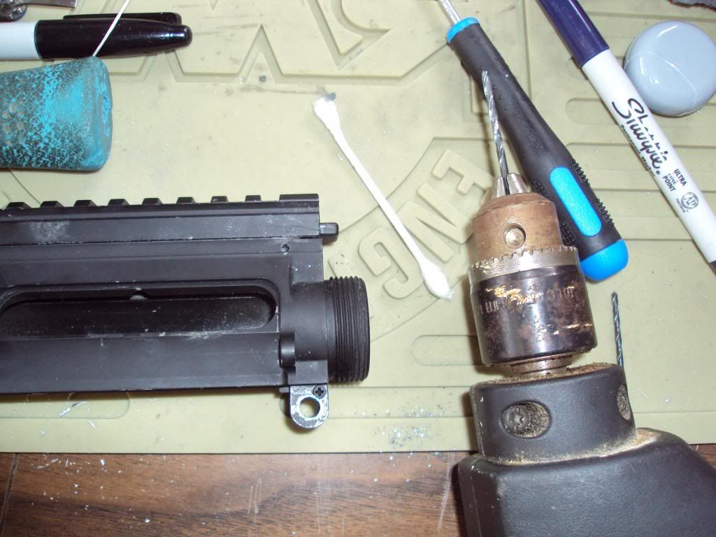

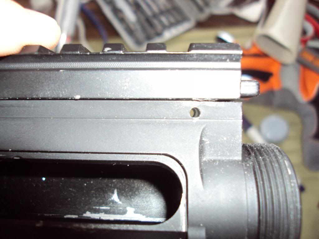

6. Drill the hole for the roll pin. While the rail was mounted on the receiver, I carefully ran a 3/32" drill bit through the roll pin hole. Be very careful if you do this. You will seriously damage your receiver if you aren't lined up properly. If you aren't completely comfortable, I advise you to measure the hole placement and drill the tab by itself.
Rail mounted and lined up:
Hole drilled:

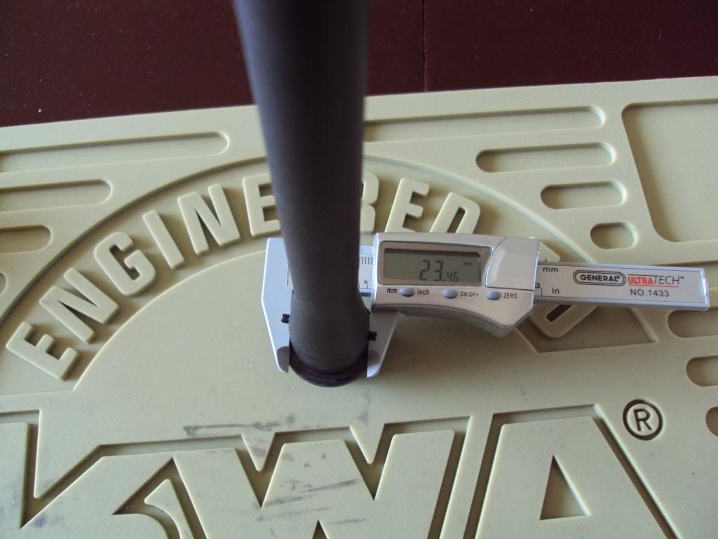

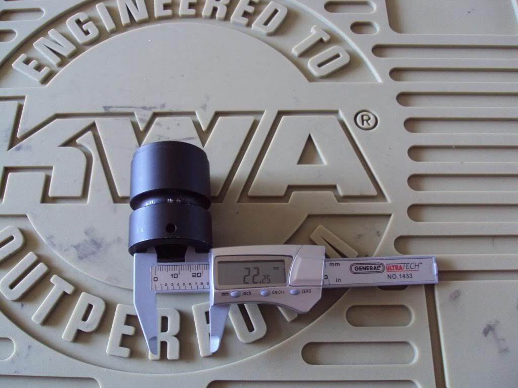

7. I used a carbide milling bit and a Dremel to shave out the ID of the barrel nut to 23.5mm (15/16").
KWA barrel OD:
Original barrel nut ID:

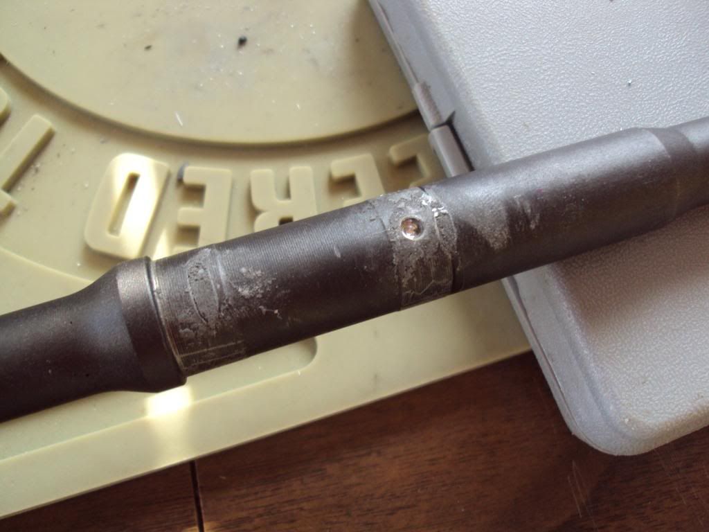

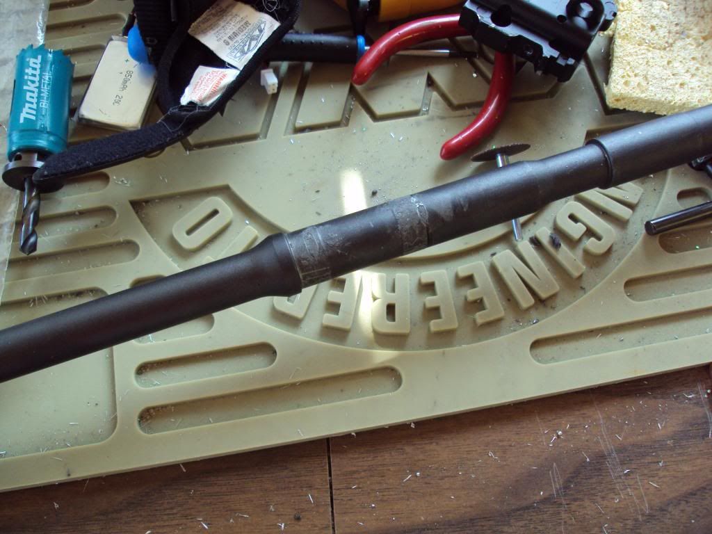

8. Gas block installation: You need a full LM4 barrel or a just the base half with a 1" extension.
Fill in the pin grooves with epoxy. You wont use them and the front one interferes with the divot for the set screw.
I lined up the center line on the gas block with the half way point on the old rear pin groove. This could be measured carefully, but I have a lot of experience. It's also only an aesthetic part so as long as it looks good. Like the upper rail, I just drilled through the gas block hole with a 1/8" bit.
Slide the gas block on and tighten the set screw.

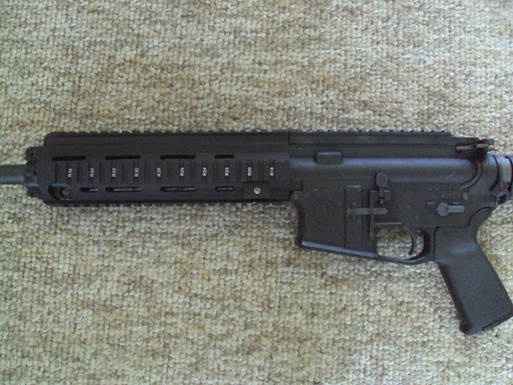

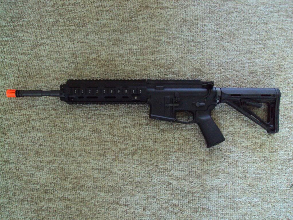

That's it folks! :thumbsup:  Pardon the long barrel and orange tip, I just used the OEM parts I had lying around. I'm currently looking for a good source of spray paint to make my upper AOR1/"gucci desert" colored.
A close up of the upper:
